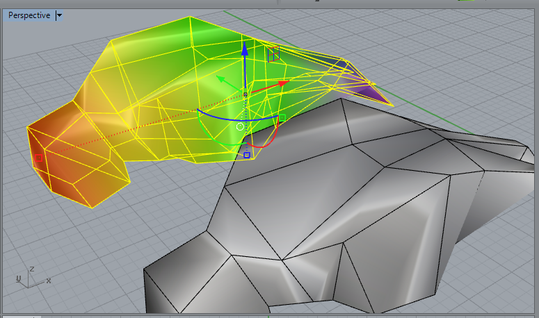

This is a file that is part of the Weaverbird tutorials. One object looks to have a thickness analysis on one object and it stays on no matter what. Anyone know how to keep a multicolor analysis on?
where is the file ?
Looks like a mesh with vertex colors - RebuildMesh will clear those, I think.
I like it, I want to know how to keep it on like this file.
I haven’t looked at the file, but could it be that you’re looking for the command ExtractAnalysisMesh? If I’m not mistaken this will extract the mesh with vertex colors, so they will stay visible even after the analysis mode is closed.
That’s it!!
