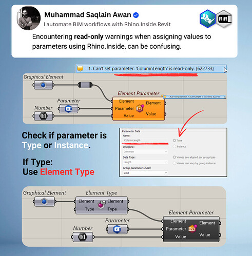

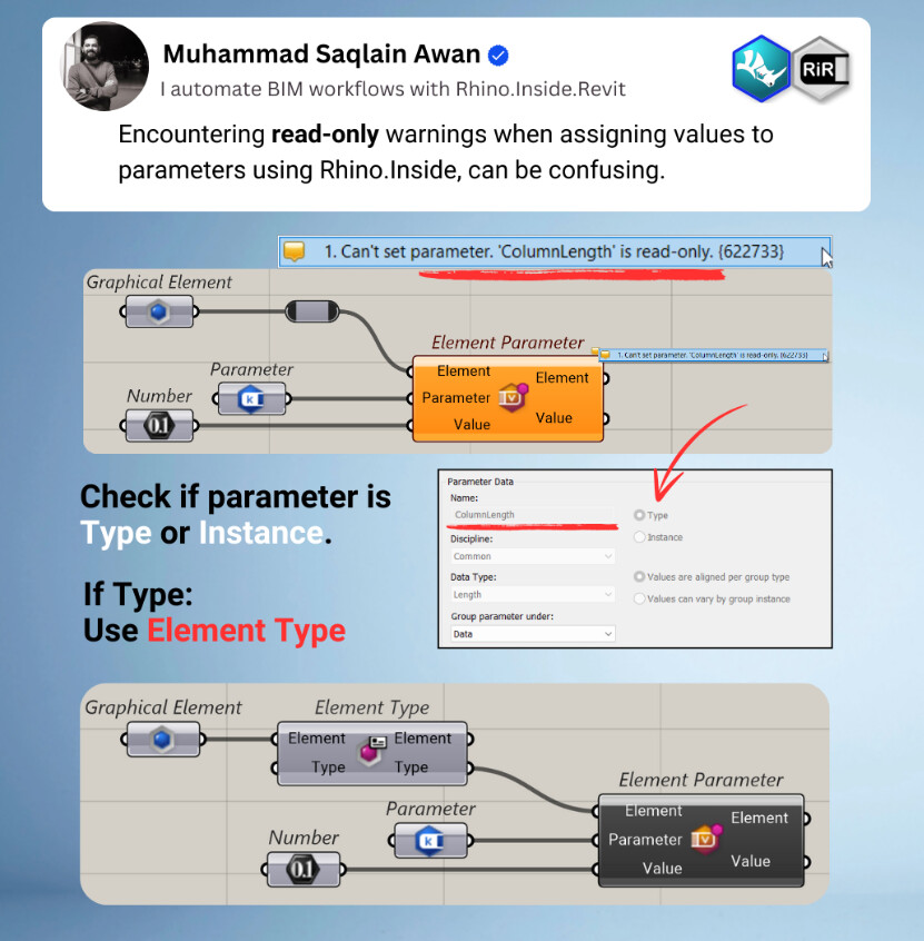

How does this work in the current version of RiR? I have a feeling I’ve done it before but I can’t work out how to do it. I want to extract a dimension inside a user-created type parameter I can’t seem to bring it up. Inspect Element just gives me the instance parameters.
Thanks
Scott
Hi @scottyvalentine ,
I believe the following trick will work. You have to access the type and then use inspect element component
Yes that was exactly it. I figured it out about 5 minutes before you posted Muhammad. Thanks for posting!!
It’s not so logical at first, but it makes sense once you realise that’s the way.
