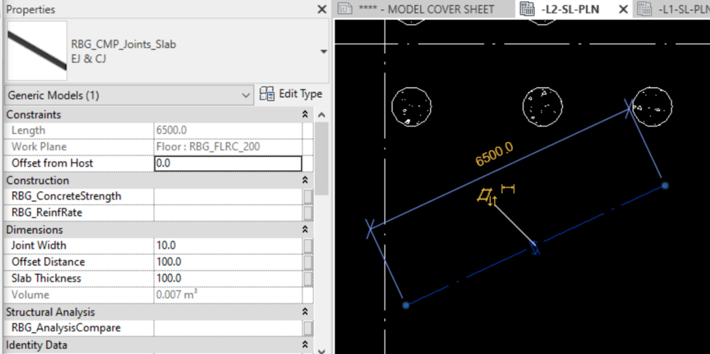

Hi RIR Team,
Whats the best way to place this family type?
Would be great to place it similar to how Structural Framing is placed.
Thinking of other options would be to update the family to be able to adjust the length to work with Component placement.
Hi Christopher,
Not sure if this is what you are looking for?
Cheers,
Joel
I have a similar query from the past wherein I want to host a Revit family by line or curve placement like the way we create beam using the component.
Cheers,
Oh Amazing thanks @Joel_Ocampo
This component is what i was after. Perfect.
Engineering Mark ups in Rhino to Revit for Slab Joint locations. Thanks
