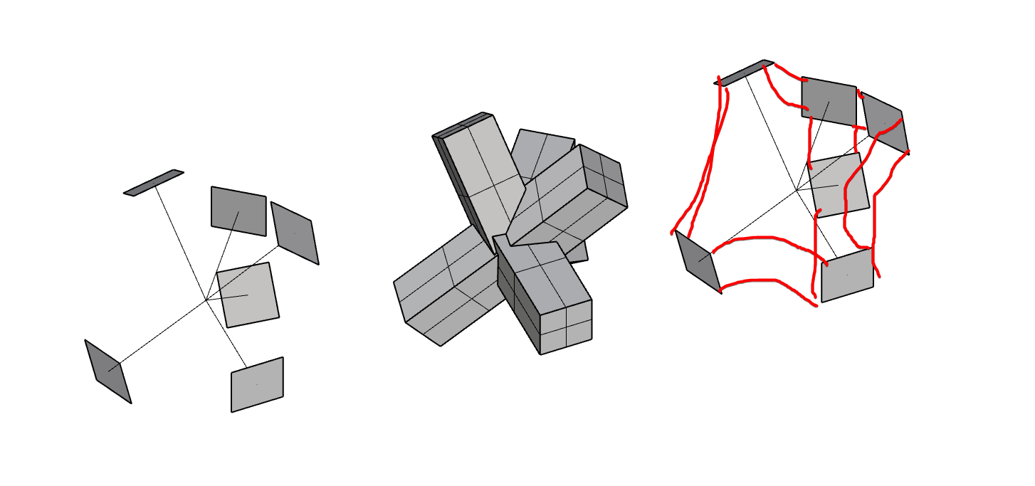

Hey everyone! I am curious if this is technically possible using just Kangaroo. Lets say if I have this joint coming from 6 square rod and I am interested in generating a 3D printed joint like the sketch I have to the right, what would be the most efficient way to do so? Somehow I can only imagine the joint with real life soap. I know how to generate minimal surface from mesh using kangaroo so does that mean I should create a mesh of the model I have to the right, setting anchors at the squares at the center and just let it work out? Thanks all!
p.s. the drawing I have to the right is not the most accurate since its more like a loft.

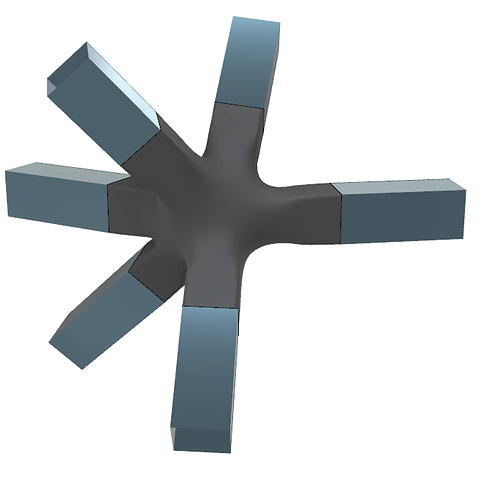

Do you need the square ends?

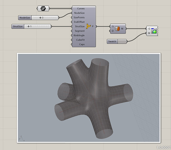

Have you tried Multipipe?

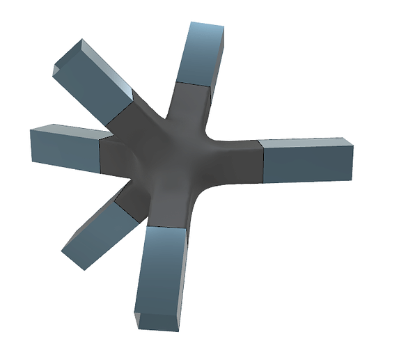

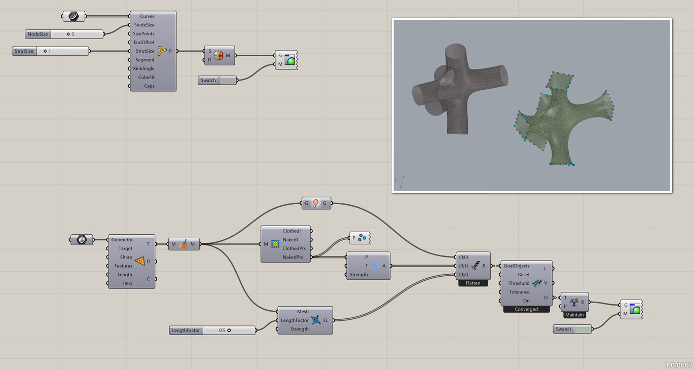

Alternative solution with Kangaroo
For discussion.gh (21.4 KB)
Yar i reckon if its circle I can be created using plugin like this. I am however interested in if its a set of square rods.
Thanks for the reply tho! I will take a closer look
check the second file, requires a brep to start, but with open ends

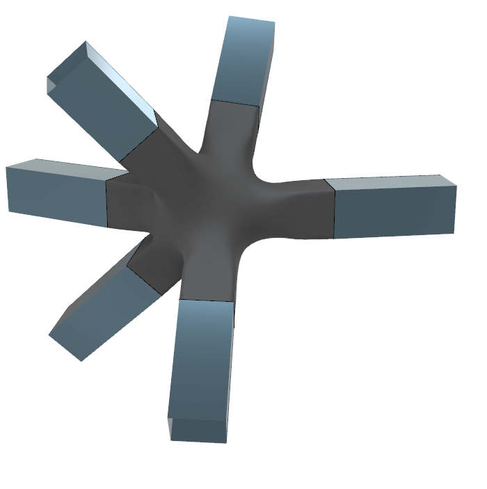

Also, if you want to keep the square ends but do more of a blend than a pure tensile surface, you can use a falloff like this:
squarenode.gh (61.5 KB)

Oh that falloff option is interesting. Learnt something new today :slight_smile:
Here’s a slightly improved version that adds a collider to stop it shrinking inside the original volume
squarenode2.gh (69.1 KB)
