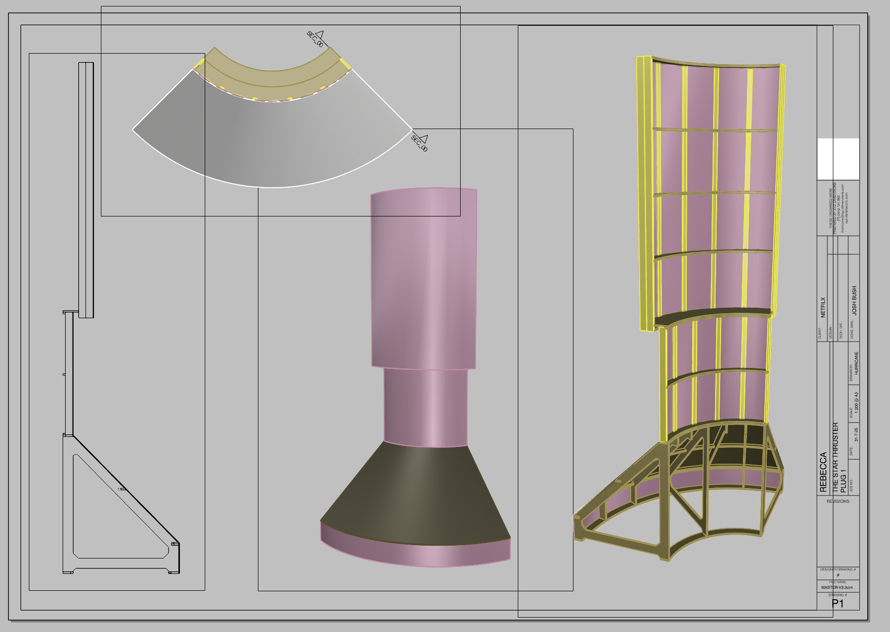

Hi Ya,
How do you apply hatches to sections generated with the Section Tools (not clipping planes)
Is it in Layer Properties or something
Yes you can set it with Layer and Properties, and there is a guide about how to set section style, hope works to you.
