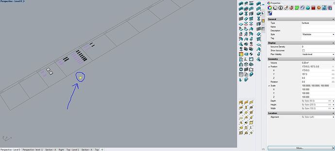

I have a problem with the furniture in visualarq2 on the cm-template,
as you can see on the attached pics, when I change the wardrobe width it deform the wardrobe to a ugh object.
the problem is relevant to all furniture.
That appears to work fine in the latest version - 2.3. Have you updated your installation?
it work fine after the update, thanks!
