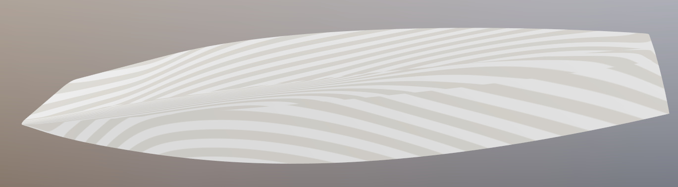

I’ve made a surface using weighted control points in order to get a nice parabolic surface that gives very smooth highlights transitions. (to obtain the same effect by manually positioning the control points would take ages and master skill) However, I would like to obtain the same surface without any point weighting, because there might be problems later when the file is used in other software, and I also have the impression that any C2 surface matching from neighbouring surfaces is problematic.
I there a way to do this without changing the shape itself?
For instance, the surface now has a degree 2 in the direction of the parabolic curvature I want: 3 points define the curvature: 2 end points with weight1 and a middle one with weight 10 (question aside: why can’t the weight go higher than 10, why not to infinity? the line just becomes two straight lines, but is really just a single line).
Now, when I change the degree to 4 and obtain 5 points, all the points, except the ones on the end are still weighted, but to a lesser degree. Why isn’t there a way the change the degree, and have no weighting left?Like “baking” the shape with normal, weight 1 control points.
If I manually change the weights of the middle control points to 1, obviously my parabolic curvature will change, and I end up with a modified surface.
Any insights?

I tend to work in surface mode since it allows me to see (by the aid of zebra lines) how the different rows of control points transition one from another. Working on lines separately is not very intuitive in that respect.
The surface at hand is the side of a boat hull and by using the weighted points it was really efficient to obtain a perfect surface result. I first defined the top line (sheer line), from there I copied that line downwards and scaled and rotated some points to obtain a lower line that is as close as possible to the upper one in terms of point distribution.
Then I do a loft (loose) between those two curves. The resulting surface has only control points on the upper and lower curve I created before. Then I change the surface’s degree (vertical direction) to 2. This gives me a en extra horizontal row of control points in the middle. Then I weight the middle row’s points to 10. Now, when I pull on that row, or scale it sideways, I obtain a distinct crease, while the surface itself is parabolic in nature.
From there, I changed the degree to 4, which gives me a surface with 5 points in vertical direction. Points #2 and #4 are positioned fairly close to point #3 (the middle one), with the same distance (roughly). Having 5 points, now allows me to control the fading of the crease from tight in the back to loose in the front. I do this by moving points 2 and 4 further away from the middle one as I go forward. (By moving, I actually mean 3D scaling a point with the one next to it as a datum, again, in order to keep as much of the original relations intact and not mess up the original, perfect curvature) This takes some of the tension out. At the back, I do the opposite in order to make the crease even tighter ( since the value 10 control point weight wasn’t sufficient).
The result is the surface as I attached. This way of working allows me to get a perfect result in hours, not days.
I tried building the surface in different ways before, but even the slightest change of control point position will mess up the reflections and would get me into a spiral of manually trying to correct a surface where it all comes down to millimeters.
But if I’m right, there is no “built in” method in Rhino to rebuild a weighted surface to a non weighted without changing the surface itself? (at least within a millimeter’s tolerance)

Here’s a model of the hull with left side two surfaces with a crease, matched positionally, wile the left side has the weighted surface
here’s a side view of the original surfaces, with zebra.
Then I cut the surface back somewhat to make room for a blend:
This was done by a split along isoparm . or can I also just split the surface somewhere, let’s say at a constant distance from the original line?).
Then I make a blend. Just check the zebra’s. pretty awful.
Curve hairs are also far from continuous:
Compared to the surface created with weighted points. Smooth as a baby’s bottom.
