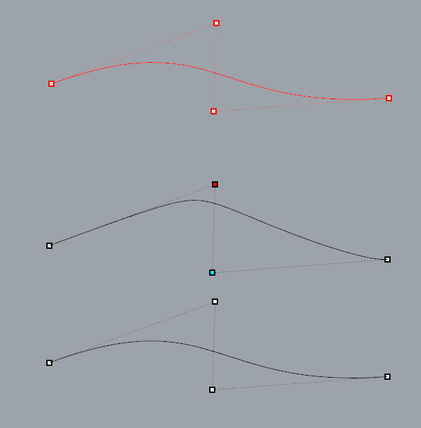

Wouldn’t it be an idea to color the white center of control points red or blue when the weight of the control point is different than 1. Red for 1-10 and blue for 0.1-1. This way it would be more easy to locate weighed points. Now I don’t use weighed control points much as they are more or less hidden.

Hi Gerard- yeah… I can see there might be an advantage to knowing about point weighting as one is working. I do once in a while run the Weight command to see if there are any weighted points.
Hi Willem-
Rhino uses weighted points a lot- any arc/ellipse/parabola/circle/cylinder/sphere will have weighted points- these are what the R in NURBS is for - ‘rational’ as in, not all weights the same, some greater then others. The ‘difference’ in weights is what changes the shape of the geometry- weighting all points the same, whatever the number, is the same, shape wise, as all being weighted at one.
They can also used to edit shapes but that is ‘geeky’.
