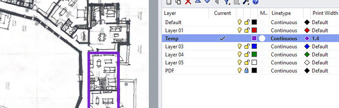

I want to get floor plan sketch to Rhino through Grasshopper. I want to get Building outline and Walls. Example image is below. Any idea where to start?
Building U L01.pdf (485.2 KB)
I would insert the PDF and get it to scale, then turn on my GridSnap with appropriate units, as well as Smart Track and Gumball. Then i would use rectangle and polylines to quickly rough everything out, using SubObject Select and Gumball a lot. I would rotate my view or have ortho angle set to a good angle. Once i roughed it in I would use Curve Boolean to create the rooms, halls and such. Probably 30-45 mins or so all together.
I would also turn on PrintDisplay and crank up the Width
