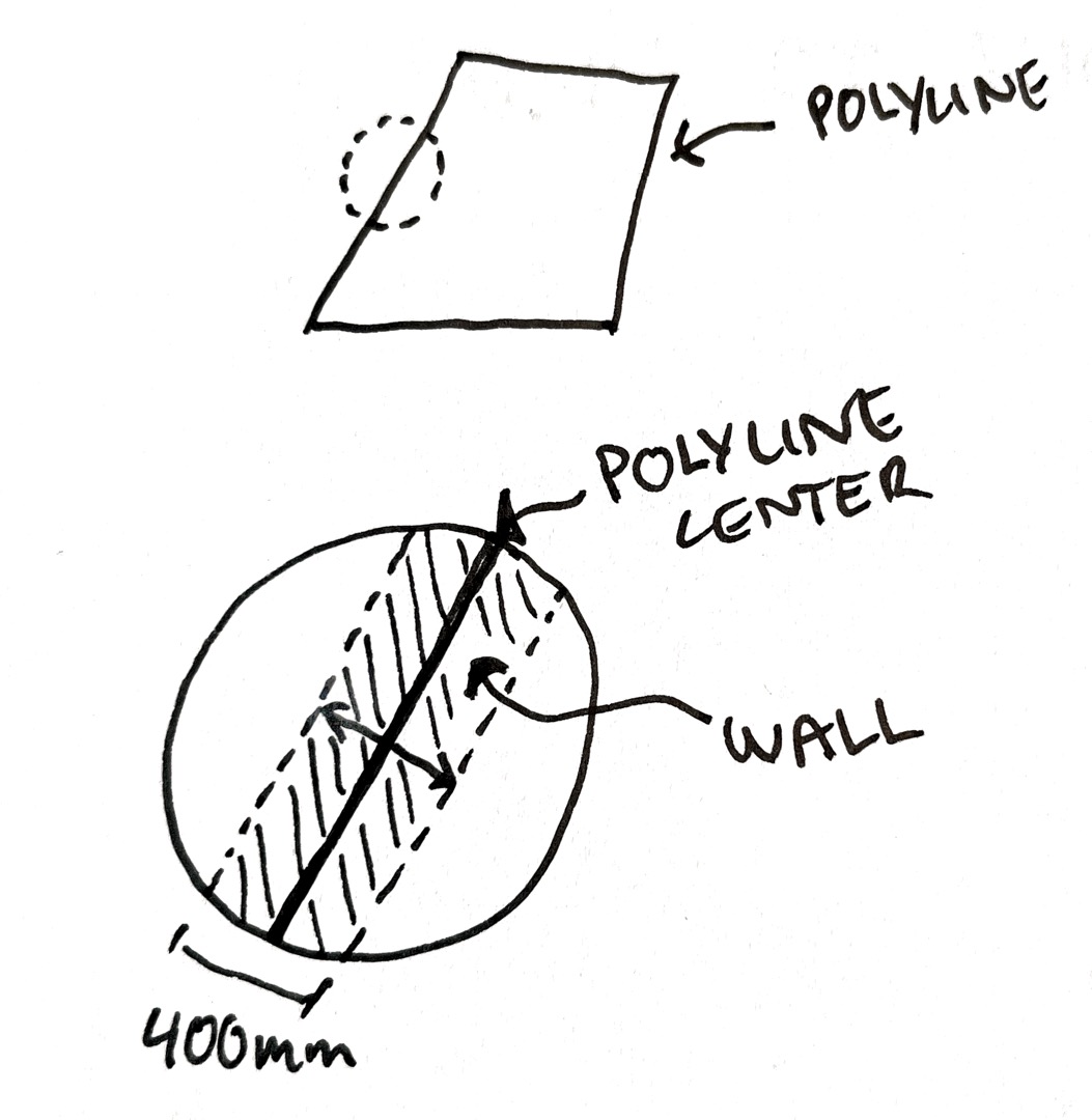

Yes, I have some ideas for that. Perhaps using the poly as a center line so that the wall thickness adjust center and out, like this?
Or offset it inside. Maybe you can add option for both (center line and offset inside)?
Actually, this might make more sense. Perhaps the polyline represents the separation of inside/outside. So inside-walls go inside the poly, andcladding goes outside the poly?
Yes, that would be great.

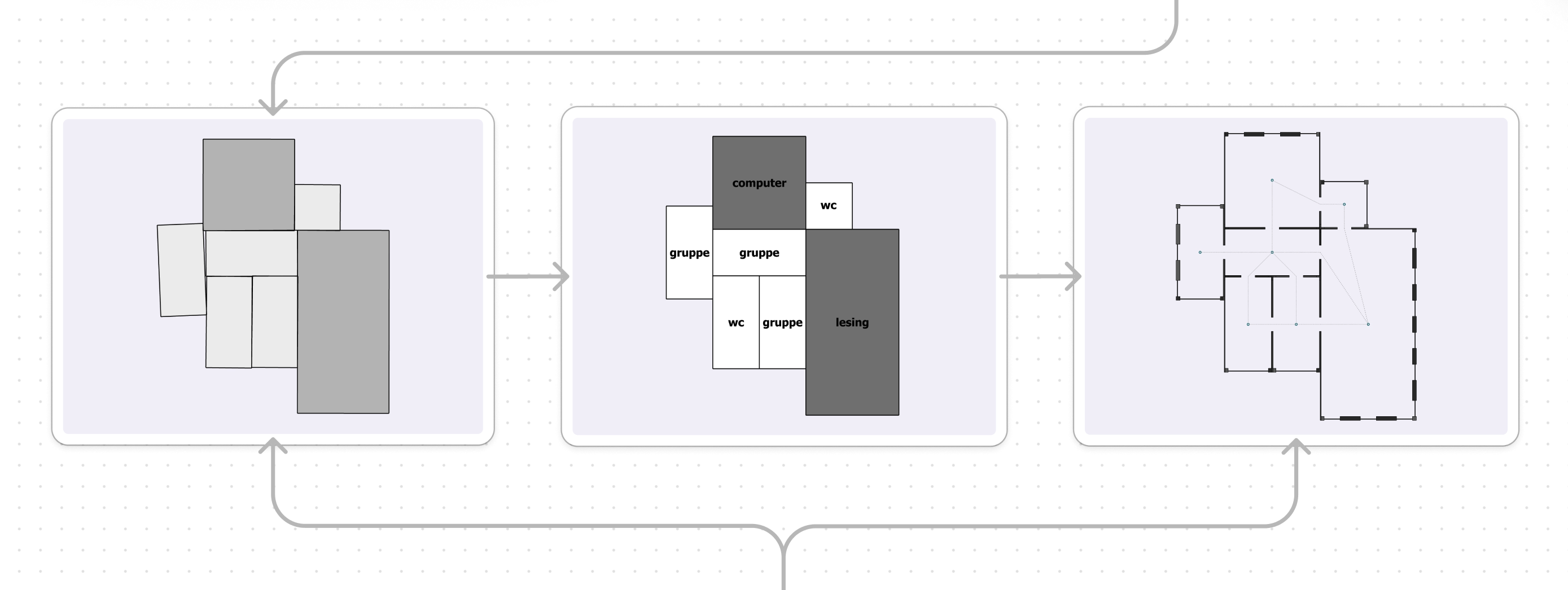

I’m experimenting with the possibility to generate plan proposals. Have to admit this is a pretty difficult task. I played around with a script authored by Yang Yankun. It lets you generate plans by pulling rectangles with collision on (Kangaroo?).
Here is a link to the original script on Git:
The plans come out overlapping and strange (left), so I built a tool to snap the rectangles to a 1-meter grid (middle), and tried to convert the rectangles into a viable plan (right).
I need to work on the rectangles-to-viable-plan definition, it’s super buggy. I’ve managed to build something that converts single rectangles to a plan with one window-facade and one door. But adding complexity is not working at the moment.

I guess what you could do, once you have the orientated room-rectangles, is separate the outer boundary from the inner lines to be able to give different wall thicknesses to inner and outer walls.

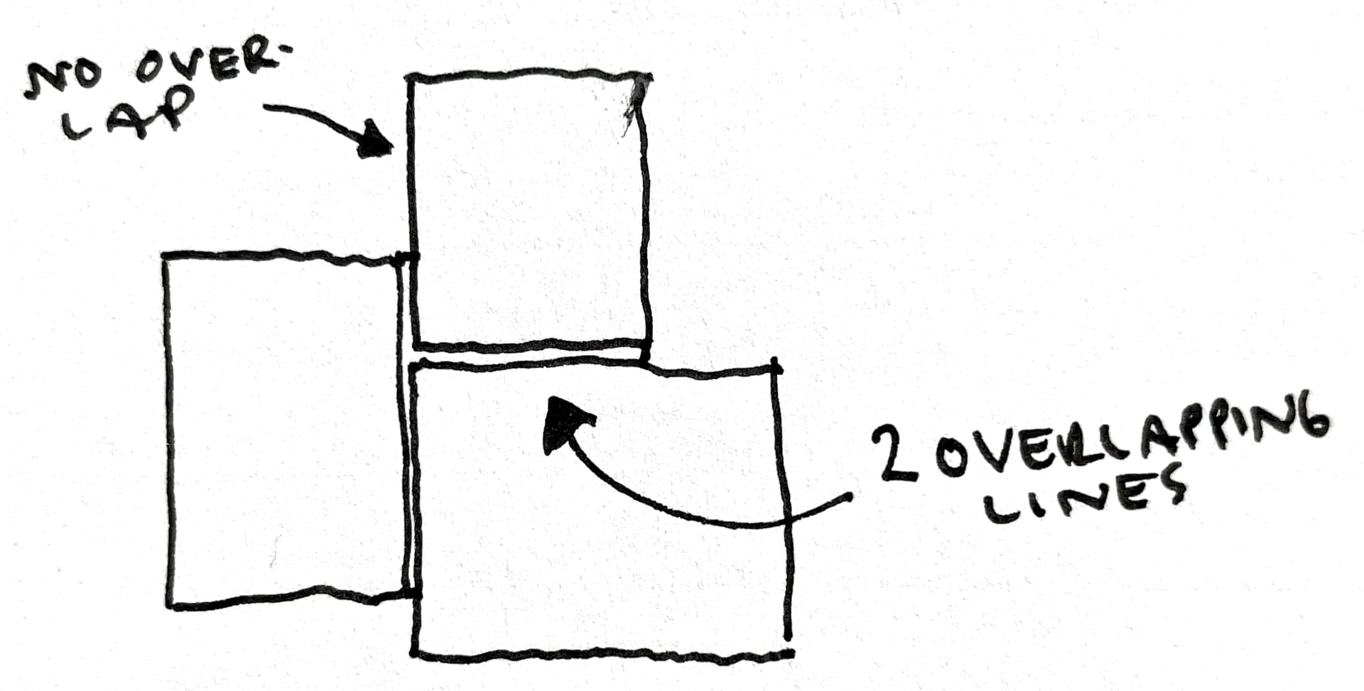

A great suggestion, I have an abstract idea of how this might work. I guess the challenge is filtering out what part of any rectangle is exposed to the outside —> thick wall/windows, and what is inside —> thin wall/door. One way might be able to use a point network to identify the crossover lines between rectangles. Like this:
And figure out a way to exclude the part of that goes outside (HM…). Perhaps a better way would be to say if two lines are overlapping, it identifies as an inner wall? Like so:
In your case, you can simply perform a regional union, which should give you the outer boundary. Then you can explode all your rectangles and for the segments check whether at least one end point is not on the boundary curve, which means that it is an inside line.
Then for all the inner line segments you again could evaluate which overlap the boundary curve and only keep the part that’s not overlapping.
