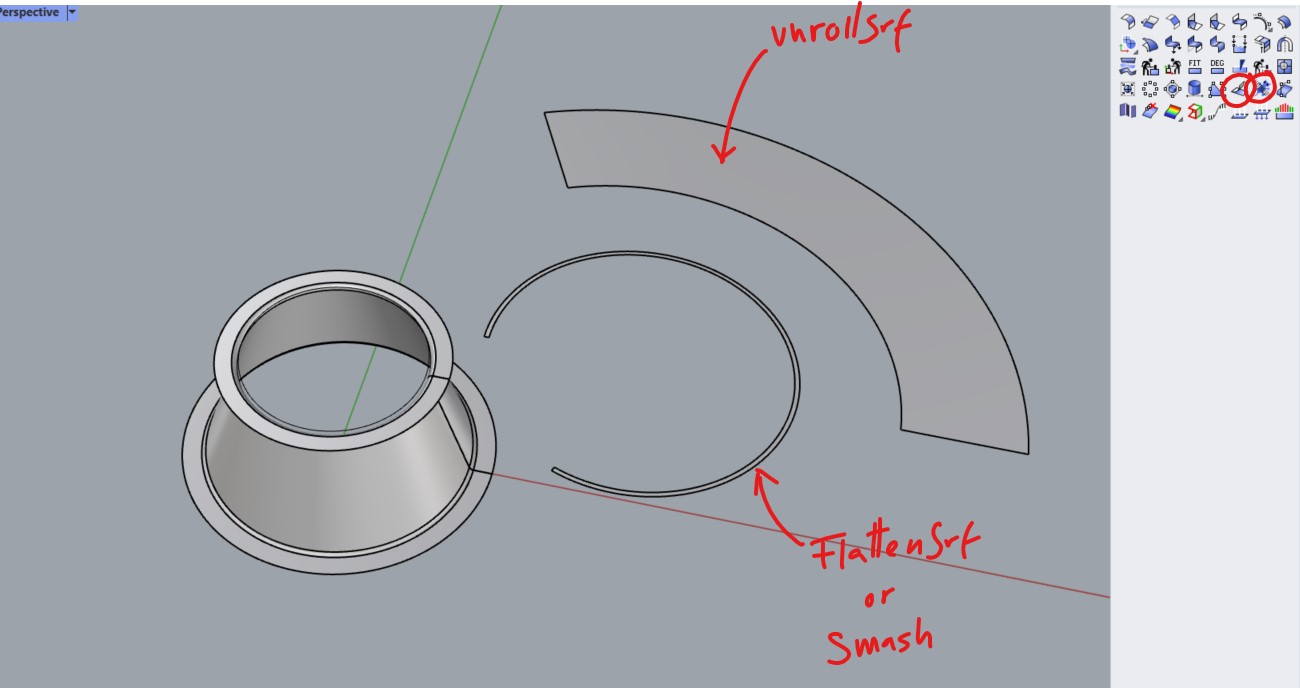

Hello everyone,
What’s the usual method for flattening plastic deformed surfaces?
See attached file for an example.
Thanx!
Cone-Flatten1a.3dm (148.1 KB)

Hello - not really - you can get the basic cone part flattened - it is developable - by first DivideAlongCreases > SplitAtTangents=Yes and then extracting the cone surface. The fillets will not unroll though- you’ll need to build that.

Well how would this be formed, what are you trying to flatten it to?
If we’re talking about “forming” operations, that’s not something that can really be “flattened,” not really. The material is flowing like in a mold, there’s no ‘unfolding’ logic to follow.

I had an add-on for Rhino v2 that flattened simpler plasti-formed plate (for ship builders), but it’s out of date and won’t work on v6. It was quite expensive too!
Because what @pascal and @JimCarruthers are saying is that it is impossible to unroll double curvature surfaces without deforming them.
If you did it in the past, maybe _FlattenSrf or _Smash might be what you are looking for? Such tools would help if the material you are using is flexible/stretchy. But that doesn’t seem to be the case.
I am not sure what the actual difference between the two is BTW. Maybe Pascal can clarify that if those tools are helpful to you.
