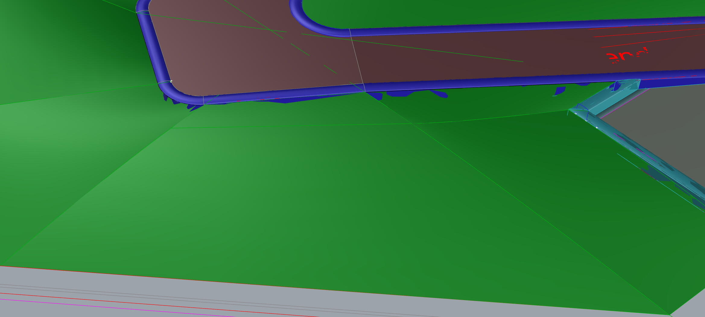

Hi. I am doing a large scene (far from the origin). How can I fix the viewport glitches? Is this because of being far from the centre of my scene, or is it about clipping properties from the viewport?

The floating point math gets wonky far from origin, best if you can move it closer to 0,0.

Is it possible to move the centre to the mesh instead of moving everything to the centre?
