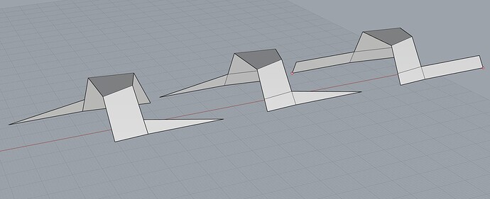

you re trying to bring together 3 Faces in one Edge.
This is called Non-Manifold
https://docs.mcneel.com/rhino/7/help/en-us/index.htm#popup_moreinformation/non-manifold_edges.htm
this is not possible for subd in Rhino
to solve this - you have to add thickness to your shell.
_offsetSubD as a startingpoint.
Im not sure how does thickening solves this problem…
instead of 3 surfaces meet in one point (red Y) the offset / thickness will not have a non-manifold issue (blue)
