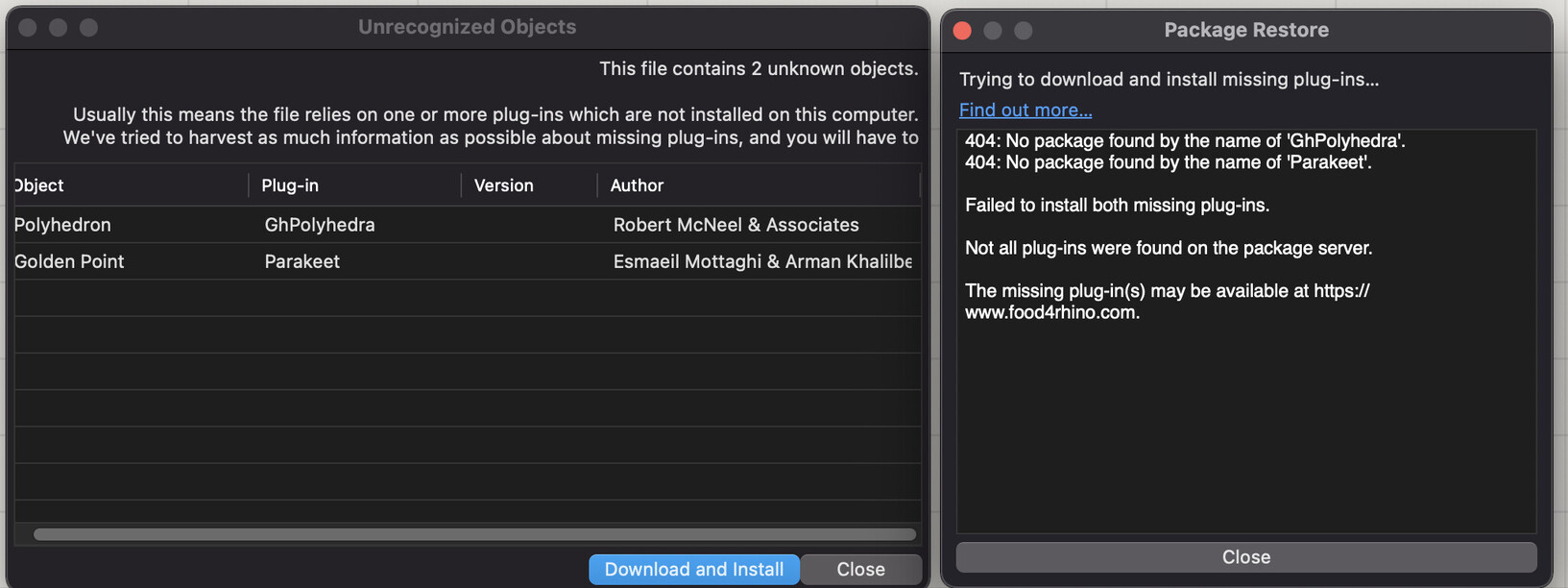

Hello @bob.h.mackay ,
Very interesting post, congrat.
A few questions :
  • I have trouble downlading required plugins. Any idea how to proceed ?
  • Maybe it does not exist for mac ?
  • did you 3D print it ?
thks in advance

I believe that the Polyhedra plugin should be shown in the Package Manager. I’m not sure about Parakeet, which I think I got from food4Rhino: https://www.food4rhino.com/app/parakeet. I see nothing on the web site about not working on a Mac, although perhaps this is the case.
That said, I am using both of these in a truly simplistic way, and both could easily be eliminated. I have them, so went the lazy way - I was not thinking about publishing!
I used the Polyhedron plugin just to make an initial tetrahedron, which is about the simplest possible thing you could ask it to do. [As a software engineer, I find it hysterical that the input argument to Polyhedron is “Tetrahedron” as a string! It will do a “Rhombic Triacontahedron” just by asking! Capital letters for extra class.]
The Parakeet plugin does some amazing patterns, but in this case I am using it just to take a line and to find the point on the line that will divide it into two parts, having the golden ratio of their lengths (1 : 1.618…). This should also be easily done using native components.

Er, actually, I see that Parakeet is for Windows. Sorry!
OK, If I claim it to be easy, it better be!
FiveTetrahedra5.gh (25.3 KB)
Here is a version using only standard Grasshopper components. Let me know how it goes!
Bob
Hi @bob.h.mackay , thank-you for your post, but it is still requesting a plug-in “Parakeet”
There is a problem (I do not know if it is related) that I do not know how to solve
Thank-you for your help
Woops - I missed a second Golden Point component.
Could you try: FiveTetrahedra6.gh (33.2 KB) ?
I hope that once the last component is deleted, it forgets the dependency.
Sorry about that,
Bob
got it! thks!
