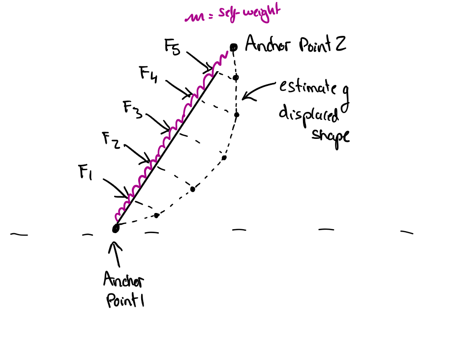

I am working on the design of a cable stayed bridge. I am in the early stages of defining the geometry of the piers. I intend to use a curve pier which will see load from its own self-weight and from five inclined point loads.
I want to maximise axial load in the pier and minimise bending/shear. To do this, I need to define the anti-funicular shape of the structure. In this shape, the structure will only experience axial load…perfect!
To define the anti-funicular shape, I first need to define the funicular shape. My understanding of the funicular shape is that this is the shape a hanging chain would adopt if the loads were applied in the orientation which would cause the chain to go into tension. Once I have the funicular shape, I can simply mirror the structure and change the direction of the loads, and this will give me my starting structure for the piers.

Hi both,
Hopefully the below sketches explain a little clearer what I am struggling with. And yes…this is just a conceptual bridge project!
The arrangement I am trying to achieve is as below
And my proposal for determining the funicular form is as below
Thanks in advance for your time

I have been completing some basic hand calculations of funicular polygons (which account for point loads but not self-weight) and they have demonstrated that in theory, some very surprising geometries can perform almost exclusively ‘axially’ e.g. the below which sees 5 x 1Mn point loads and is circa 30m in height. Exhibiting just 8kN.m bending moment is excellent for this example considering the magnitude and direction of the applied loads. Certainly a scary prospect as you say maje90.
The self-weight of the structure causes a major departure from axial behaviour…hence why I want to develop a more robust method for defining the funicular form.

Well… we can skip everything and do the good old static problem around a point…
bridge 2.gh (17.4 KB)
Central pivot point “K”.
The sum of the momentum generated by the bridge cable stays is equal to the momentum generated by beach cable stay.
Each bridge cable stay have constant force and direction, but each cable have an increasing distance from the pivot point, thus momentum. Calculate total momentum.
Given a beach point, beach stay have a tension equal to the total momentum / beach stay distance from pivot.
Starting from the top going down, we can compute pier beams inclination by subtracting the bridge cable stays vector… one by one reaching zero.
Messy script, probably can be shrinked further …
Edit: oh, surely this doesn’t take into account the self-weight of the pier/beams/cables… :rofl: i forgot about that!

Grasshopper won’t accept recursive data flow , so I did cheat it with 2 data dams, but that was just a lazy solution, certainly prone to create ambiguity like your questions…
Here the solution with anemone:
bridge 4.gh (20.9 KB)
Now Pier node weights is calculated to consider any half-beam connected at each node, and multiplying that length by a factor.
