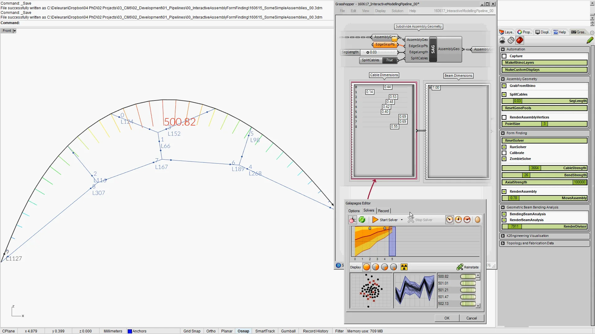

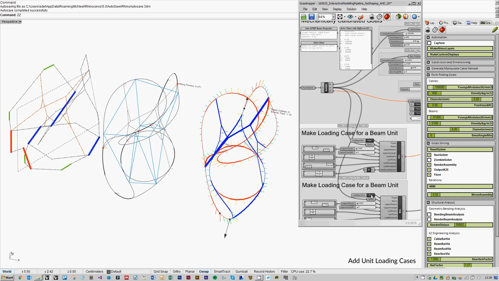

Perhaps what might help here is just some better tools for seeing the tension in each cable for the actual structure as you manually adjust the rest lengths in the form finding.

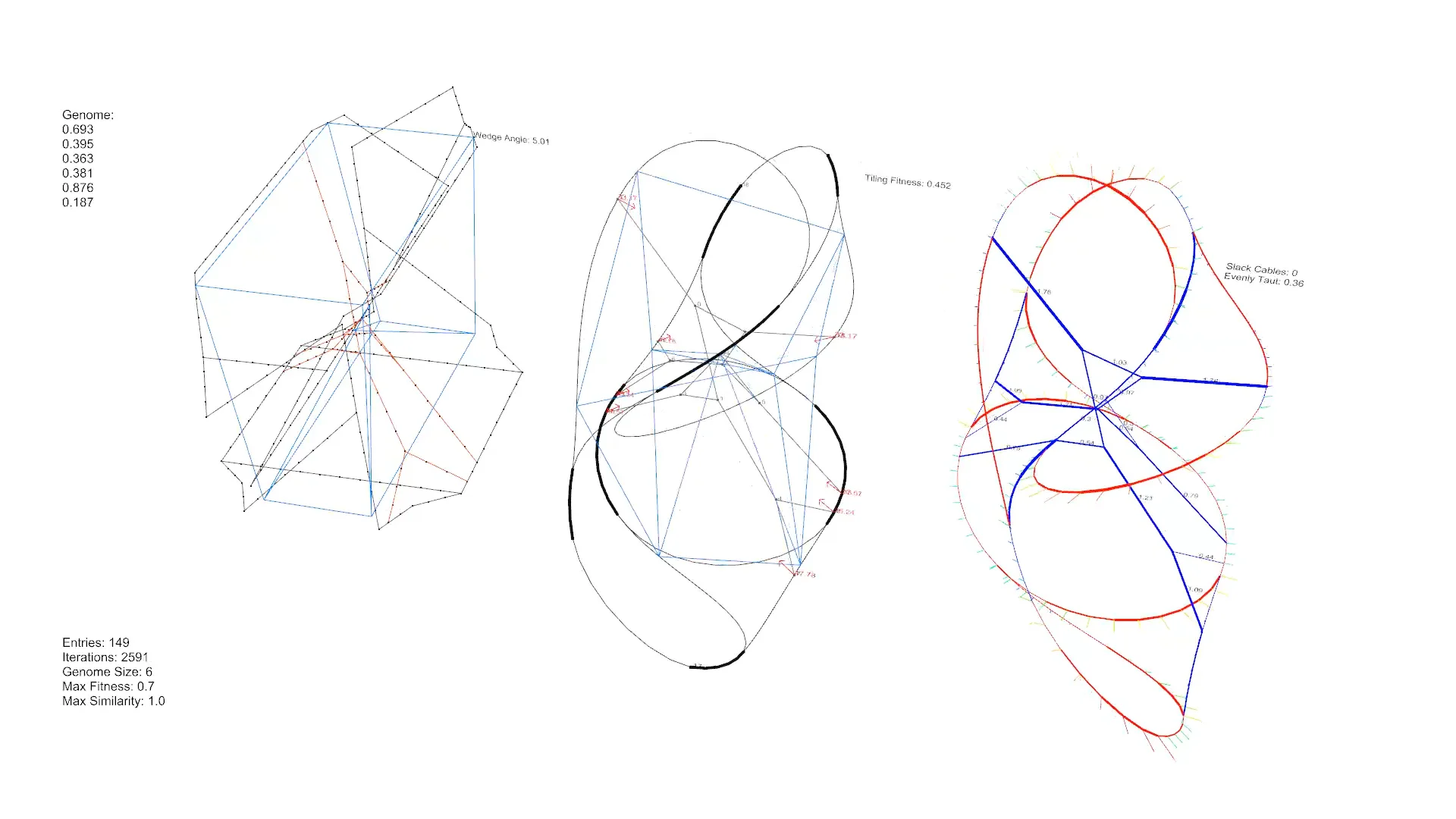

I’m reminded of the Smart Geometry 2016 and LaceWall modelling we did, particularly the concept of treating the lengths and/or starting positions of a cable network as a search space (where in this case, the desired tension might serve as the fitness criteria). Anywho, some examples from that that may inspire ideas:
