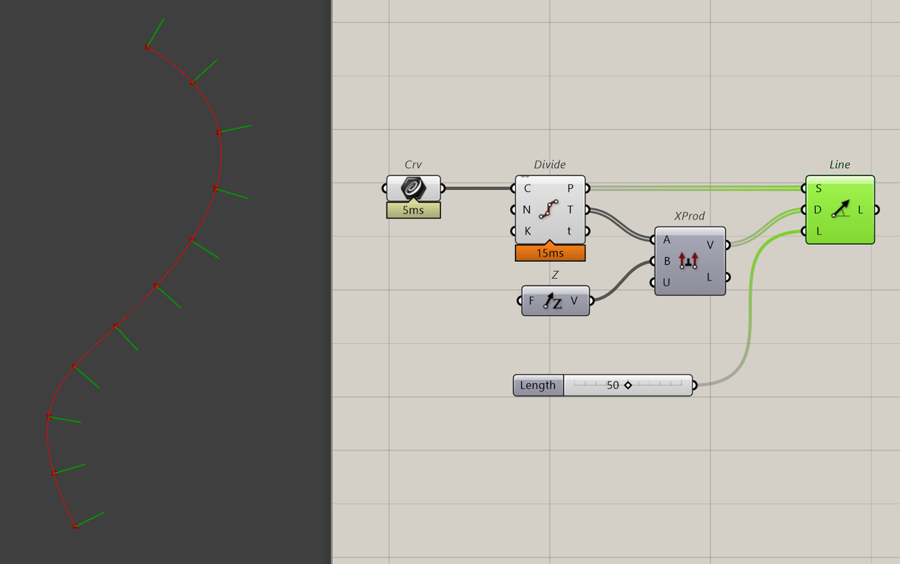

Find a Normal of a curve (line perpendicular to curve)
Fairly simpel question but I can’t find it.
Is there a component which generates the Normal to a curve?
So drawing a curve which is perpendicular to the curve?

In which plane?
Perp Frame or Evaluate Curve would be the two commands / components to start with

You can also use Curve frame

my favorite method (especially when you want to clamp/control the rotation):

do you have a good explanation of what Cross Product is. I love how simple this solution is but would love to understand it more so I can evolve my knowledge on how to use this.
Thank you
The right-hand rule seems like a good explanation to me.
