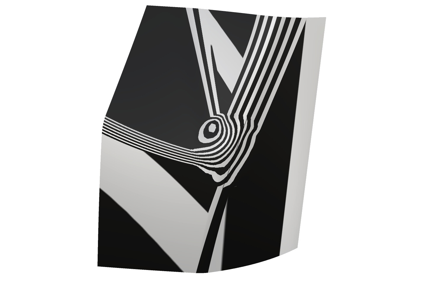

5-side-hole - guitar neck
taken from this topic
FillSrf
there is some minimal bumbyness - it can also been seen when pulling a curve to the _fillSrf
onshape / parasolid
that s the winning result - also in attached file
i think it s a nice example to finetune some of the crazy advanced pramaeters
guitarNeck5side_00_fillsrf.3dm (4.6 MB)
looking forward to the next updates / developments - cheers -tom
Looks like the bumpiness in your FillSrf result can be improved on by using DegreeU=DegreeV=3 and Bending=0 in the Advanced options. This is food for thought, thank you.
