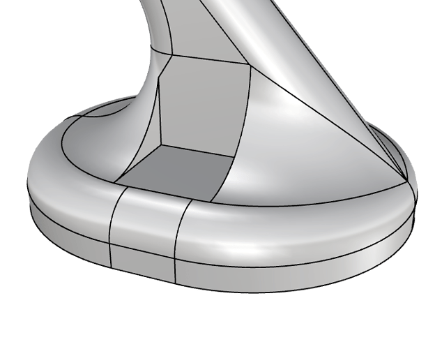

ok i post a first version. based on (a wrong) approaches of my students. i ll call this version “v01 maximum pain”
forget everything in the layer “Version01_Max_Pain”
but the curves will get you a faster start… the mesh reference is also in this part
one first version including a wrong apporach, but all info and initial curves to start fast and fail soon with boolean and fillet…

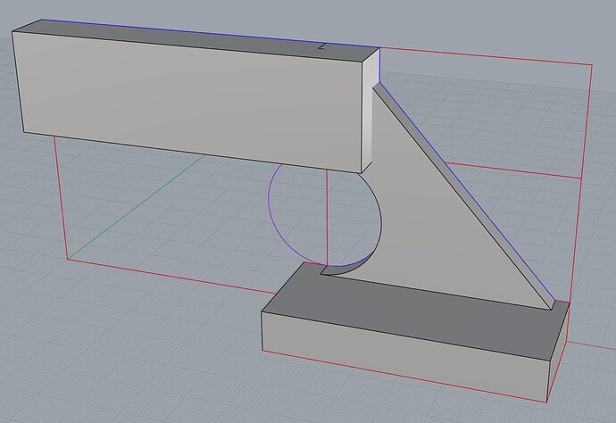

these details in the (attempt to do a fast ) tech-drawing - i hoped show what s going on there…
not showing all fillets
for simpler geometry i love the approach to show the geometry in solidworks style, without the last fillet in the planar view, only in the perspective.
but then - which of the steps should i take - all will give some wrong information because the solution is only possible with _filletSrf … (maybe setPt …) _trim _join Workflow
this first version will show somehow a “legal” way without any fillet - and with some additional surfaces that will fall away (but will kill rhino s fillet algorithm)
one step further - not bad - but this state shows some lost surfaces - that are needed for the final version
this last version - maybe the best - only the R4 fillet missing - not very realistic exercise as it already requires a full cad model - - including the first R4 - telling the necessary hierarchy to solve the problem…

The starting surfaces are actually the faces of the solids you posted ( I only drew a cylinder and a sphere instead of the upper box ) then I simply used FilletSrf and Trim.
The tricks are simply using (possibly enlarged) original (untrimmed) surface to help Rhino with fillets that start at the edge of the surface.
And a couple of cylinders to help building fillets that would end on a surface with the same curvature radius as the fillet radius.
Auxiliary surfs are green in the file.

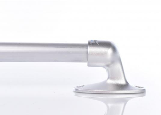

by the way - this was the initial inspiration of this object - but the transitions are more complex and not pure fillets:
img_2017-12-27_13-15-41_7d7d5d637baacf84b6f8e07488599f9c
