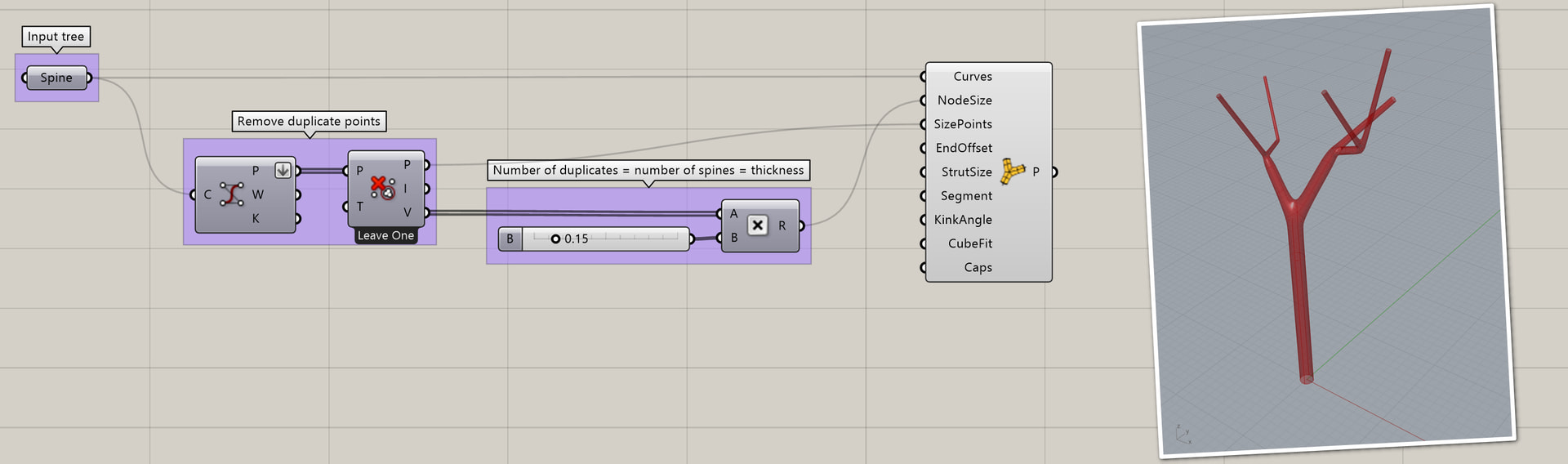

This morning in the shower, I realized it should be possible to have the thickness at each vertex be defined by the number of spines that go through it. Each spine is a poly line that connects a tip, or leaf, with the root of the tree.
Here is the outcome:
2025-02-23+08_polyline_pipe.gh (37.3 KB)
I’m a bit surprised you’re finding MultiPipe too slow.
Here’s an example with over a thousand lines, and it’s still quite interactive when adjusting sliders:
treepipe.gh (13.0 KB)
Are you maybe trying to apply this to many separate trees? If this is the case then the path structure matters, so it builds each graph separately.
This example also makes use of the node sizing interpolation in MultiPipe - if you input sizes at only some of the points (here just the tips of the outer branches and the root point), it automatically blends the sizing at the intermediate nodes.
edit- just saw you’re talking about hundreds of thousands of curves. In this case the SubD rendering probably adds a fair bit of overhead. You can connect a mesh parameter to the output of MultiPipe and hide the preview for the component itself to avoid generating the mesh of the SubD as preview. Still I can see it might be useful to have an option for the component to skip the SubD step altogether and only output the mesh.

Thank you for pointing that out! I probably applied MultiPipe to tree of curves instead of to a list. For my small example, it works very well:
2026-02-25+08_polyline_pipe.gh (14.8 KB)
For the big tree, performance is fine. But there are some weird artifacts. The result looks more like an inflated balloon sculpture than a tree.
2026-02-25+08_polyline_pipe_big.gh (25.6 KB)
