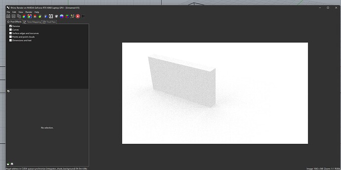

If I open a new file file and try and render a box, it will do a few samples and give the error: Illegal address in CUDA queue synchronize (Integrator_shade_background)
if I try it again in the file with the box or my main file, it will give the first error I mentioned.
Screenshot for context:
Not sure what else to suggest here other than to use CPU as rendering device. Yes, it’ll be much slower, but at least it won’t have the error.

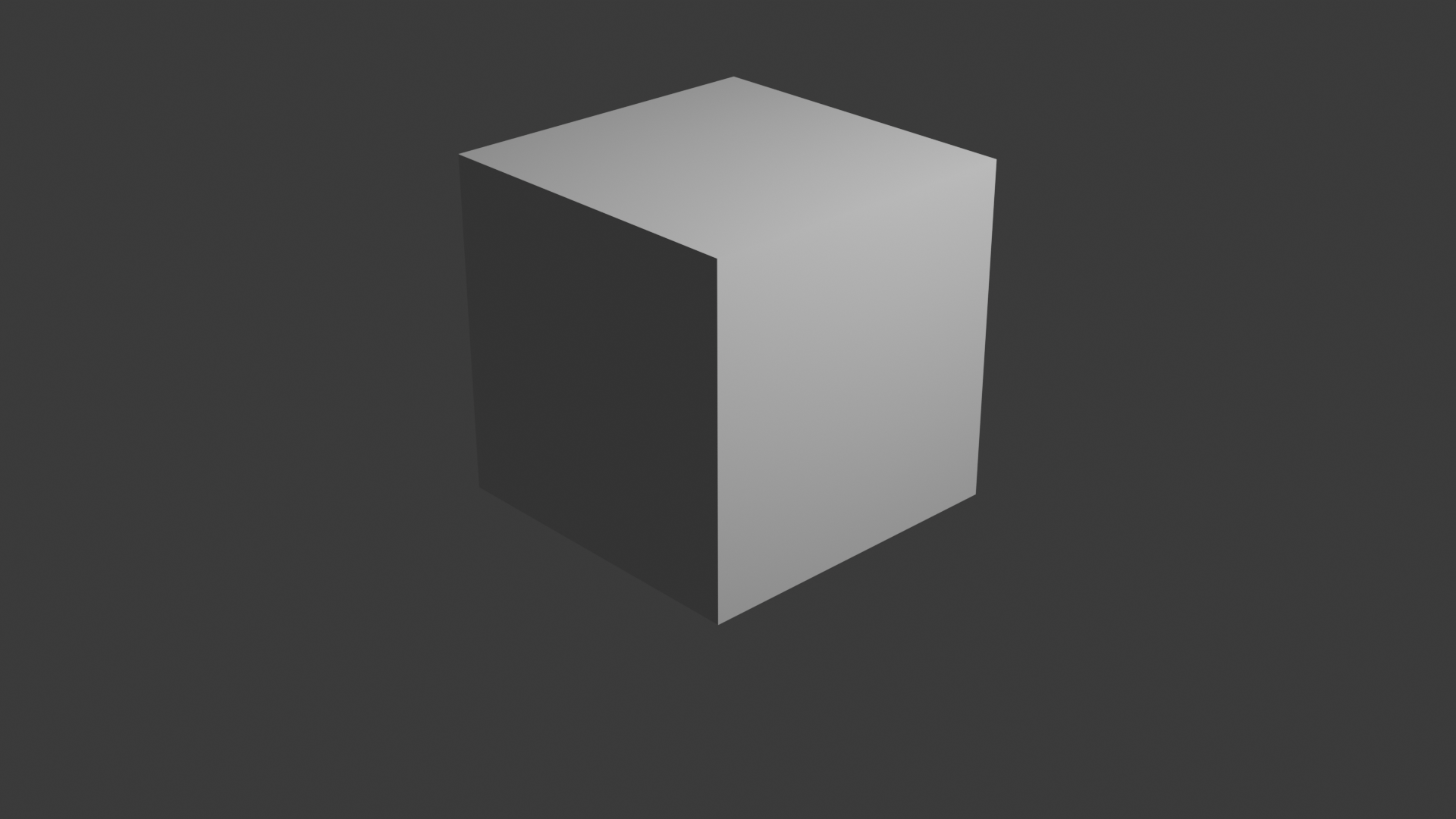

It’d be interesting to see if you get issues using Cycles in Blender 3.5 (closest to what we have in Rhino 8) as well. Just download the ZIP, extract it somewhere and run blender.exe, then choose to render the default scene with Cycles.
It seemed to work just fine: here is the image.
Just to double-check: you did make sure Edit > Preferences > System has CUDA or OptiX set. And then before you render the default scene that Cycles is set as the render engine and GPU is set as the target.
On first render it will take a couple of minutes for Blender to compile the kernels for first usage - it will say so in the render window top left.
Just double checked those settings and it output a similar error to Rhino.
Interestingly enough, I had GPU compute and CUDA selected for the first render that seemed to work.
The engine was still probably set to EEVEE, I guess.
But “good” (in a sad way) to see that Cycles in Blender is showing the same issue.

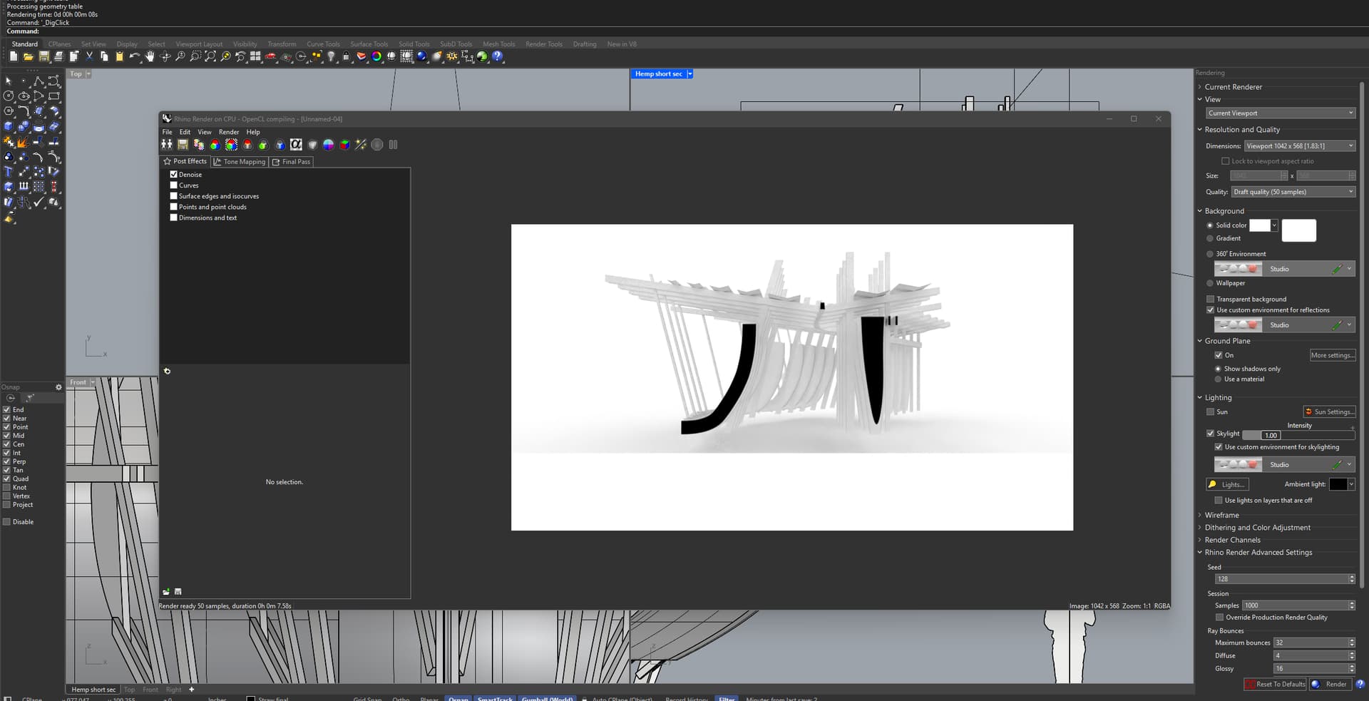

I tried getting the absolute latest drivers and then running a render again and it actually worked on the main model.
I managed to get two to work, one at draft quality (50 samples) and another with 500 samples. All other settings were default.
However when I attempted to render the default blender scene to confirm the fix, it gave the same ‘Illegal Address’ error. when I went back to the rhino file and tried to render another model it failed again This time with a different error: “Illegal address in CUDA queue synchronize (integrator shade shadow)”
I’ll attempt to roll back my GPU drivers by a month or two ASAP like you suggested to see if that works.
