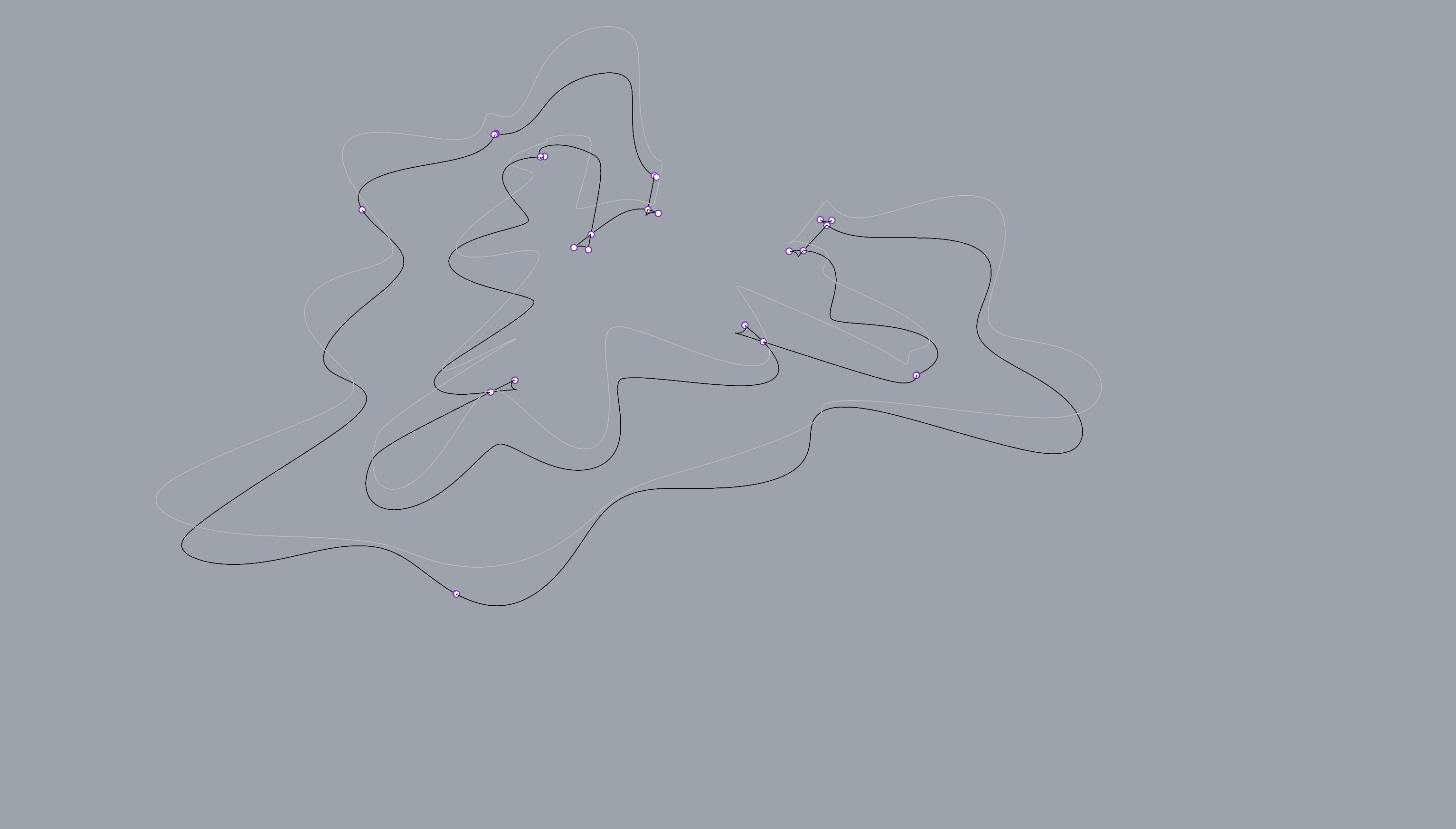

Hey Guys, i need help in creating a wavy façade pattern on my wall, Unfortunately my script says that the Planar surface routine returned no results. Can you guys please help?

@Abenezer I was able to edit your script so you can create surfaces from the curves. I would just edit your wavy curves so they don’t self-intersect, I showed the intersections with purple points.

Thank you so much, I`m gonna try it
