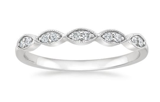

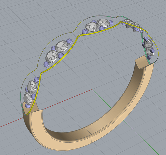

I am trying to recreate the pod section of the ring in the image. I have drawn the pods out as a flat curve and bent them around the inner circle of the ring. I intended to extrude the curve out solid and booleon the indentations in for the stone settings. However, every attempt to do so is met with the same error, this uncapped shape.
I have tried offsetting the curve from a surface, sweep 2 rails and loft. All are met with the same result.
When I attempt to cap the shape, it says “unable to cap one object, object did not have closed, planar loops of edges.”
When i try to join the curves, it says ‘cannot join closed curves’ … and zooming in shows nothing wrong. so why is it saying it is both closed and unclosed at the same time… this isn’t Schrodingers curve.

I have managed to cap the object using the ‘Edgesrf’ command and joined the surfaces. Now a new problem arises. Every type of attempt at a booleon fails. difference, intersection, union and split.
Cap will only work if the holes are closed and planar. The latter part appears to be what was missing. It sounds like you got that issue sorted but if you had a circular curve of the same diameter in the side or front view, you could also extrude it and split that surface with your existing curves to get the top surface.
For the Boolean issue, it looks like the problem may be the coincidence of the surfaces or something might be open. You could try a small scale of the shank from it’s center to test if the coincident cylindrical surfaces are the issue. Post the 3dm if you can if that doesn’t help.

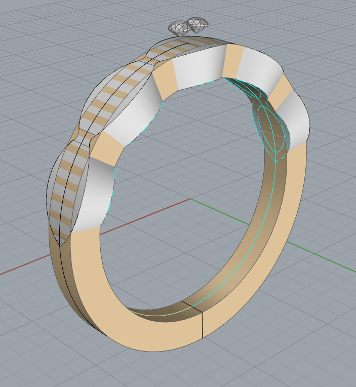

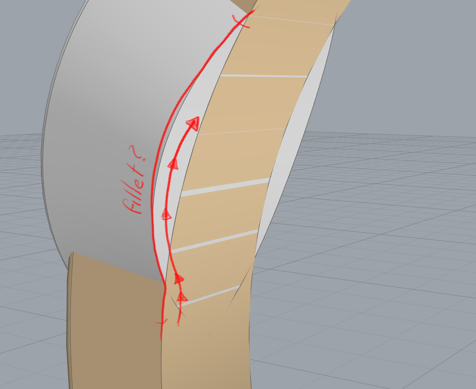

I have however run into further issues haha. I am currently trying to fillet the outer edges of the pod section. However when I do, it just creates lots of overlapping surfaces all along where the fillet should be. I am quite stumped as to how to approach this problem. I forgot in the early stages of modelling to fillet the corners of the end pods, so perhaps thats giving me an issue. Ive taken some screenshots that ill add in below, and the .3dm if i can.
Rhino_Ring__001.3dm (6.7 MB)
There are number of naked edges and overlapping surfaces in that polysrf which need to be repaired for the fillets to work well.

I realized that I couldn’t fillet the bottom edge of the pods because I had booleoned out the pods from the Shank, leaving a V which is revealed if I fillet the bottom edge.
I have rebuilt the shank so the inner surface of both the ring and the pods are flush. Is there a way that I can merge them together so that I could fillet the entire inner edge of the ring so that the shank and pods flow together? As well as remove the top half of the ring that intersects with the pod openings?

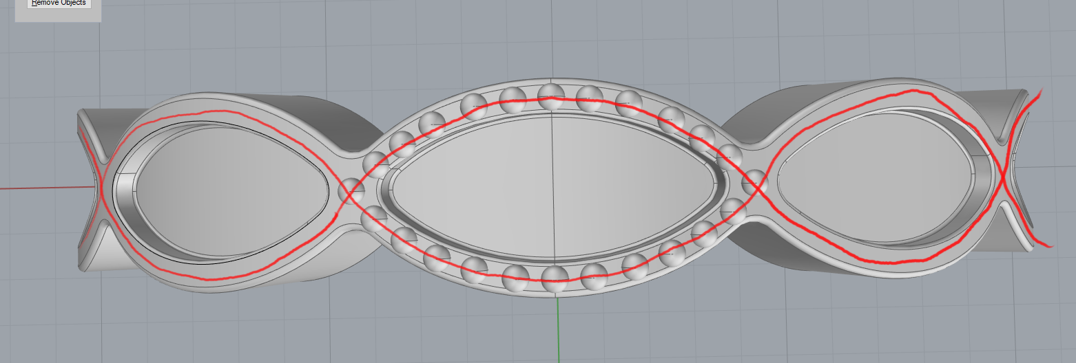

Also I am trying to make a Sphere sunk half way into the surface do an Array around the pods. I am trying to use Array Surface, but I cant think of a way to draw the control curve onto the surface. In hindsight I should have added the guideline in the 2D before I began. The spheres i have there at the moment are just place holders to give you an idea of what i am trying to achieve.

For the bead detail I’d use ArrayCrvOnSrf. Here’s a video showing how to get the curve path too…
