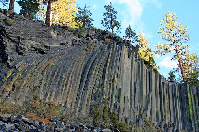

I’ve been trying to model some basalt columns as a fragment of a landscape but I am having difficulty achieving even an approximation of the form as seen in the image below. At first glance I thought this might be a good chance to start learning Grasshopper but I can’t even figure out the correct tools to use (or whether it’s even possible and i’m wasting my time)

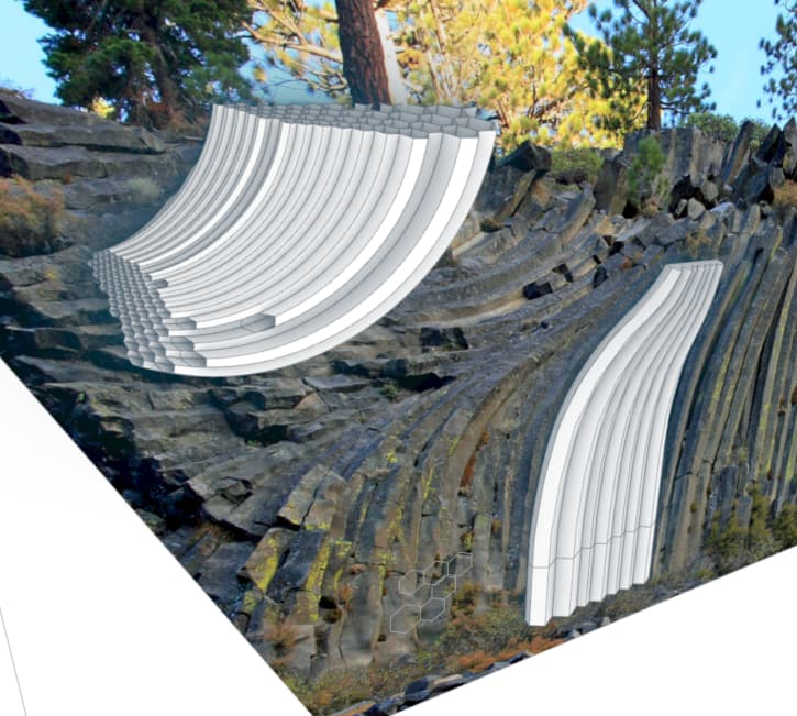

I tried first with simple SubD modelling, then moved onto Grasshopper using hexgrid and mobius transformations from Kangaroo to obtain some ‘sweeping’ of the extrusions. Looks fine for certain fragments, but I can’t figure out a better way to achieve the middle part of the image where columns sweep from two different directions and merge together. The second image shows my attempt, bottom right is a manual subD (yuck), top left is a mobius transform (a bit better).

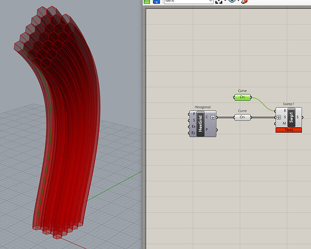

starting from something as easy as a hexagon grid and a simple curve you can sweep those together and get interesting flows like this:
the main point is what happens when multiple flows (multiple shapes/sweeps) have to move together and at the same time be perfectly-separated non-compenetrating entities :slight_smile:
don’t know what sort of precision are you aiming for, and if you are happy of getting a nice visual effect without digging too much into the compenetration thing…
hexagon_sweeps.gh (4.6 KB)
Something like this may help :
(I don’t see a reason to work with Subd modeling in your case)
Random_cliff-pattern.gh (21.3 KB)

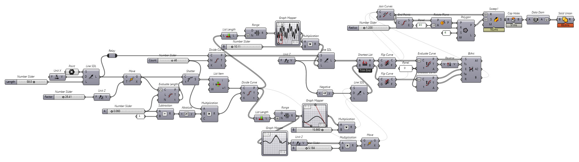

As I thought about this way earlier , I tried to make a logic based on Field components .
The algorithm principal part is above, but there is more components in the following for extruding , adjusting polygons etc. (which can be found in the file)
