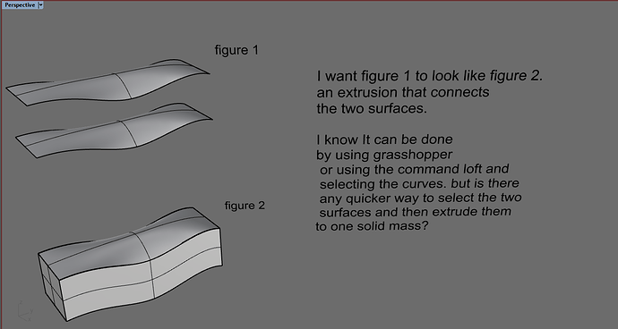

Thanks for the quick reply, here’s an image of what I’m trying to say
so basically, I want figure 1 to look like figure 2.
an extrusion that connects
the two surfaces.
I know it can be done by using grasshopper or using the command loft and selecting the curves. but is there any quicker way to select the two surfaces and then extrude them to one solid mass?
Hi -
Generally, a 3dm file is more useful. By the looks of it, it seems that the two surfaces in figure 1 are identical. In that case, you can use ExtrudeSrf and extrude one of those two.
or, activate gumball, drag the gumball down and before you let go press and hold ctrl. that will extrude it either.
in case the lower surface is different, extrude past the lower boundaries, select all and use CreateSolid and delete the rest. or use * infront of Loft like so *Loft that will keep loft open and you quickly click all the lines through till you are done.
