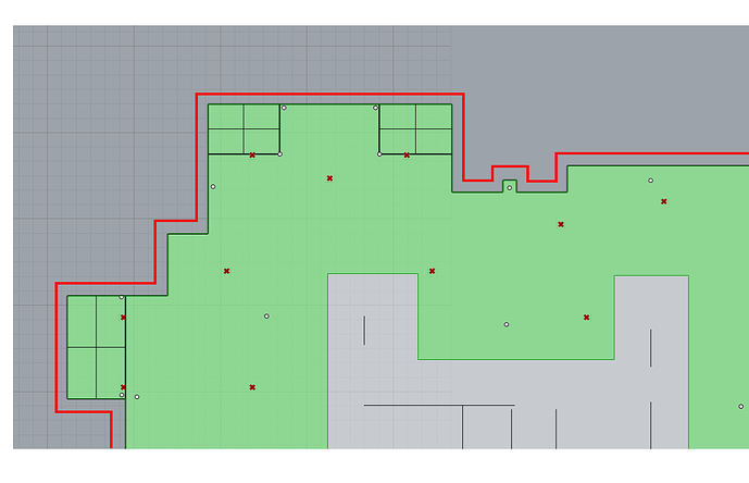

It gets more coplicated if I have a slab edge that is irregular…like this:
I tried to do something like what you said and end up with this:
I would have to somehow extend all lines and cut them at their intersections then create a surface/brep?

Sounds like you want an Offset Curve applied to the entire perimeter curve, not segments of it?
Please see GH file with the geometry internalized. Yes, it sounds like an offset curve would be what we need here (or maybe there is something out there that works better?). It gets more complicated with edges that have multiple changes nearby and would require trimming of the lines?
