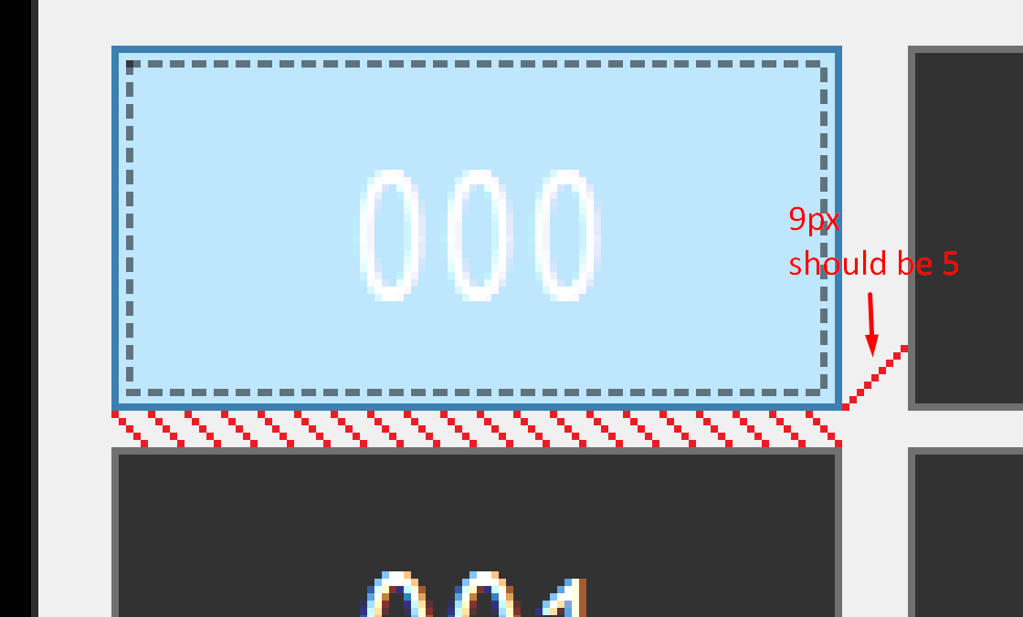

Eto.Form horizontal spacing between the first two columns is incorrect
Any idea why?

maybe try False for that scaleWidth arg
That did it. Not even Grok could figure it out.
