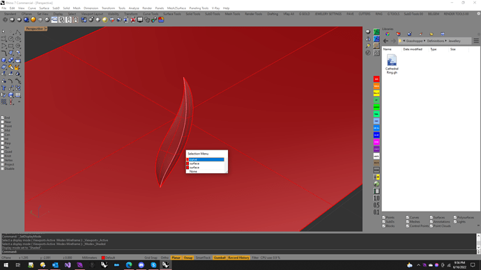

Engraving on Ring But looks likes hand carving
I would draw a single curve in the center of the design elements where you want the sharp edge to be, lower the curve by the desired depth, then do a loft from the edges of the top surface to the curve to create your carving effect. This example uses 2 curves on the surface that I use to trim the desired shape, then a curve draw from point to point, and lower the control points in the middle.
