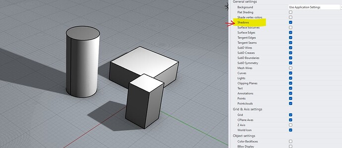

How can shadows be enabled/disabled using scripting?
This works from inside a c# script:
private void RunScript(bool x)
Guid id = this.RhinoDocument.Views.ActiveView.ActiveViewport.DisplayMode.DisplayAttributes.Id;
//Guid id = Rhino.Display.DisplayModeDescription.RenderedId;
Rhino.Display.DisplayModeDescription dmd = Rhino.Display.DisplayModeDescription.GetDisplayMode(id);
dmd.DisplayAttributes.CastShadows = x;
Rhino.Display.DisplayModeDescription.UpdateDisplayMode(dmd);
Thank you Riccardo @maje90
