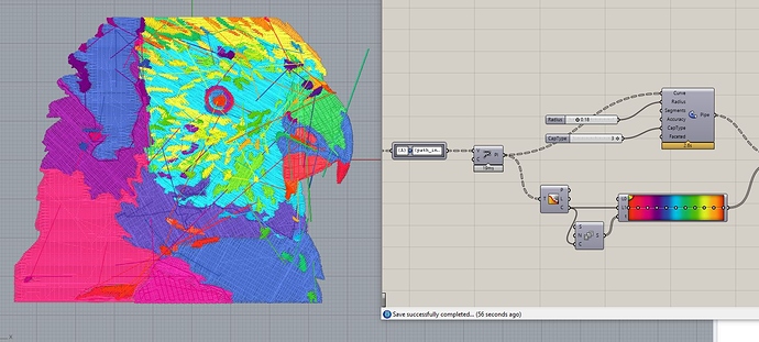

Hello, i use a tool called Embroidery Gcode Generator to generate gcode than i extract points from the code.
I don’t find a plugin which can read gcode directly, this will better to extract points faster and the real colors.
Steps:
  • Create dst file with Embroidery software.
  • Convert dst file to gcode with Embroidery Gcode Generator; sadly the tool is very old and can’t save the gcode ,so i need to copy it manually.
  • Extract points with Grasshopper, the animation is possible but it need long time.
Update
Grasshopper can read gcode file (*.GC) like any text file with Read File component
Animation with colors
Embroidery needle animation
Needle moved, Needle fixed

What do you use to generate the thickness with that amount of lines?
There are many softwares and many of them looks similar and are very expensive.
If you buy a machine use the software included.
I use mesh pipe with low settings
Which one do you use?
I use Chroma
Chroma have a free version which i used, and embroidery softwares have more tools and designed to work with embroidery machines, we can’t do that with grasshopper.
As you see in the videos i used grasshopper to create animation, not for create embroidery designs from images.
