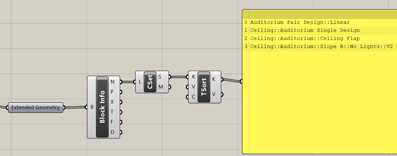

Also, I noticed another which is when I tried to Get Block Info to get the name of one of my blocks named “Ceiling::Lobby::Extruded”, it failed to output it correctly and gave a wrong name -“Lobby::Extruded”. It seemed to cull the first word. I’m sorry I wasn’t able to get a picture of this. Anyway, I hope you guys are able to fix this.
Sorry, I’m going to need your file and script to recreate this, unfortunately. In my testing, it works fine and I cannot recreate the issue.
Regarding the Get Block Info error, I took a look at the example you sent me previously to see if I could recreate the issue. There are two things happening:
  1. eleFront keeps track of when a block belongs to a worksessioned file. When this happens, the block definition has the parent file in its name:
So eleFront ignores anything before the ": "
I will change this to look for the “3dm” signature, but in the mean time, the reason it’s causing you problems is:
  1. I suspect you’ve got an extra space in your block name, since I can see that happening in the example file you sent me previously and that exhibits the same behavior: the name with the space after the colon loses the first name.
Like I said, I will change this so it only drops it off when there is a “3dm”, but I would also give your blocks a quick look and see if fixing the name solves it for you.
