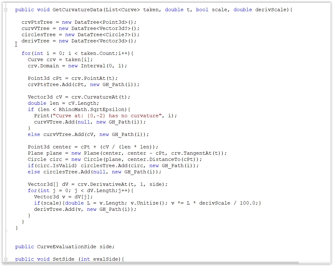

For the points/t values part I would suggest something like this:
And for the curvature data something like this:

Use this demo as a base and add Methods for finding curvature stuff on specific points of interest (like a given continuity condition for a given edge curve [related with the 2 adjacent BrepFaces] etc etc).
Surface_WhatIsCurvature_V1.gh (123.9 KB)
Thanks Peter,
Between this sample and a post by @DanielPiker
I was able to match the absolute curvature deviation from the EdgeDiscontinuity command as described here
By extracting the principal curvature from the osculating circles and converting it into a Radius value that aligns with the commands results.
