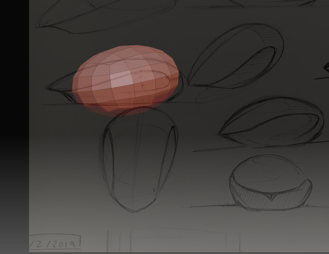

Maybe try with simple primitive sphere then some tweaks like in these pic.
Other style :sweat_smile:

Attempt to 3D-sculpt rapidly, freely - open-source options for this are many!
Rough it up, with symmetry, super fast - pull, push, flatten, Ctrl + Z
bring it to rhino and intersect it, making curves:
reverse it, collect both NURBS and polygonal/hard-surface knowledge while doing this, try NetworkSrf, EdgeSrf, draw the curve directly on the imported mesh, etc.
