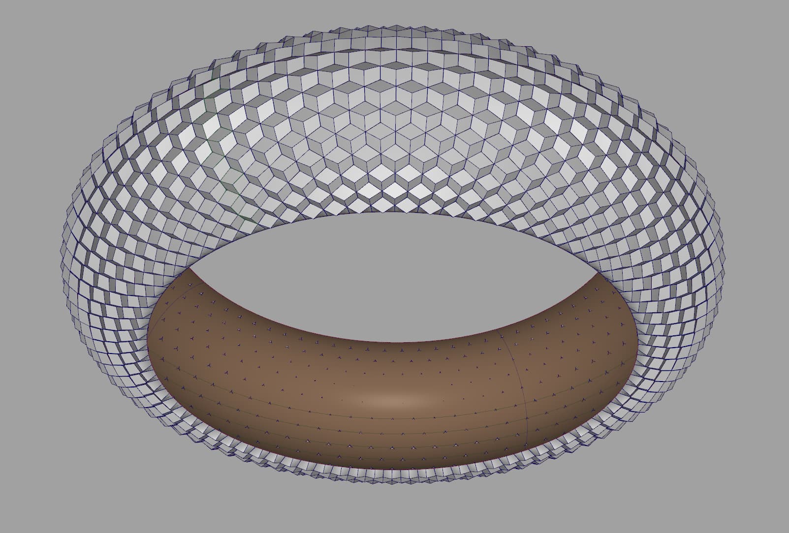

Hi I build this pattern in Alias studio tools, but I’m trying to learn grasshopper. Can anyone help me get started. It will be much appreciated. The surface donut shape and pattern are brought in to Rhino as IGES files. The pattern is all close at the seams and edges, but is floating inside the donut shape because as you can see in the images all corners dont touch a normal grid floor from plan view?
Any help getting this started will mean so much…

Hi Laurent, thx for the replies. Sorry for the delayed replied. I have been doing other projects as well. here I will be attaching everything I have tried so far. Still having issues but making progress. I tried a few things. I have figure out a few things by trial and error too. I installed the Lunchbox pluggin and couldn’t get it to work to do anything I want it.
in this picture I can’t get the shape to be continuous all around. Don’t know how?
in this pic there are gaps between the shapes that I’m trying to avoid.
my pattern shape edges are 3mm all the way around but I can’t get the hexagonal 2D grid to be 3mm all the way around. I thought if I could do that all the edges in the pattern would line up.
probably with Lunchbox it can be done but I don’t know. I will attach all files and even my original Alias Studio tools as an .iges file so you could see my original intent. Any help will be greatly appreciated…and thx once again

This is how it supposed to look. Sorry I couldn’t upload the .iges file here is too big///

You will find here a small tool. There are rooms for improvements (cubes seems to much deformed)
Need Nautilus plugin !
hexagon on surface donut.gh (15.3 KB)
Hi Laurent, thx for the replied and thx for sharing. I will check your nodes and see if there is something I could try, but like I said is not a full donut. If you look at the last images, I shared you could see that the pattern comes to an end at the top it doesn’t roll in same as the bottom. I know is very complicated to control from an edge but that is what I’m trying to achieve. Thx once again for the replied and trying things on your end, much appreciated.
