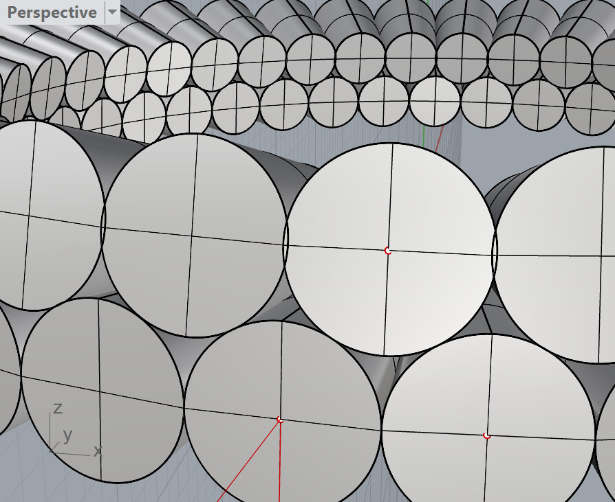

I am trying to make a dome out of truncated cones for a project I am fabricating! I have not used rhino in a while so i am a bit rusty.
I have been using arraypolar to put my cones in a circle, but whenever I use orient to start the next tier of cones, they rotate and the angles get messed up! Can anyone think of a better way to do this?

If you want a ring of cones to sit neatly row on row so that each cone rests on the two below it then you need the same number of cones in each row. Since the circles of latitude get smaller as you go up, the diameter of the cones has to get smaller as you progress up the rows. Here’s an illustration of the overlap you get if you keep the cones the same size:
The more rows you go up, the greater the effect.
If you make the cones smaller, you also reduce the vertical angular displacement and that must be taken into account in calculating the position of the next row.

Thank you for your thoughtful response! I fear that you are correct!
