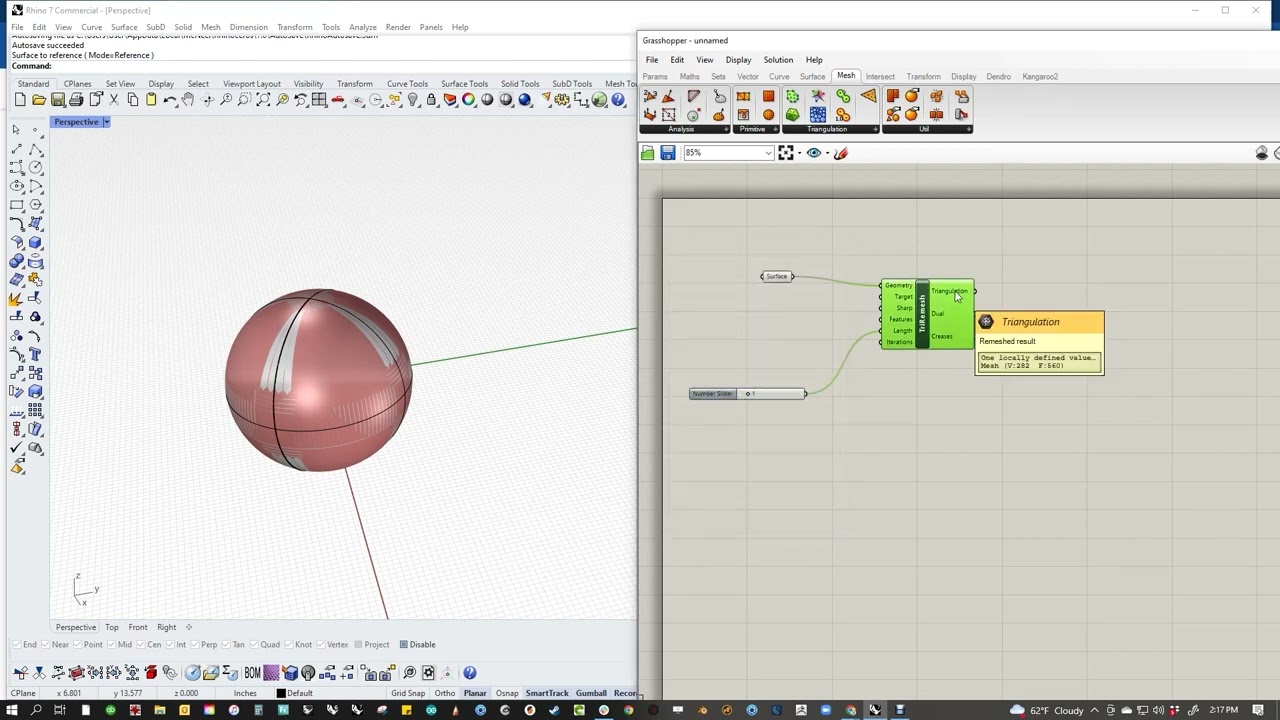

Is there a command or plug in to divide a surface into triangles or equal or near equal parameters?

Hi Ian - I would look into Grasshopper and/or PanelingTools for this.
A cheat might be to mesh the surface, and then TriangulateMesh or even ReduceMesh, which will triangulate, then use the mesh edges to split up the surface (ExtractWireframe), but I suspect you want more control than that.

I was afraid that was going to be the answer. I have absolutely no idea how grasshopper works. If I have the object in rhino, how do I import it into grasshopper? Yeah I know the most basic question.
I found a grasshopper plug in that should work. Now I just have to figure out how to use it.
try quadremesh first, then run triangulate mesh, that may get you close without grasshopper.
if you want to try grasshopper,
you can get a pretty simple result.
(i suuuck at gh, and I was able to pull this off, which means ANNNNYONE can do it. )
see video
