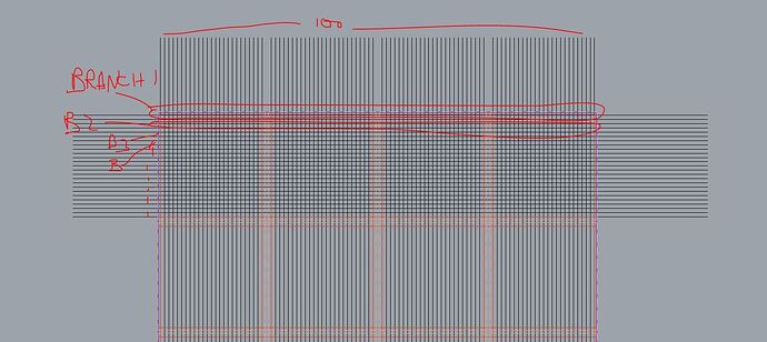

I m doing a custom grid points to further divide in branches, each would contains 100 items each ( as the grid line) but having some problems with the result… is it correct using path mapper component to achieve this?

This should do the work.
divide tree grid point_2_RE.gh (21.5 KB)
ah yes exactly, thank you @Jakinta
