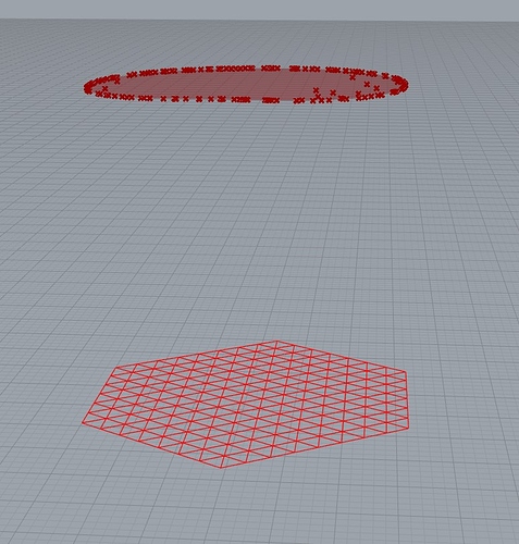

Hi!
I’m trying to divide the attached curved mesh with a triangular grid. I want the divided triangular mesh surfaces to have equal areas. I’m new to grasshopper and I can’t think of a way to achieve this. Can someone please help me out? Thank you!

Your shape is probably not possible to divide with equal triangles (without the edge shape changing to at least some amount, or the curvature). How important is the boundary of the shape?
Not so important. I want to change it using straight polylines to connect between nodes of the grid on the edge anyways.
You should check out Mesh Machine, it is probably your best bet. https://www.grasshopper3d.com/profiles/blogs/meshmachine-update?id=2985220%3ABlogPost%3A1085830&page=2
Thank you Michael. I had a look at the link, but it seems that the size of the triangle divisions are all different. Is there a way to achieve same area triangles with Mesh Machine?

Try to recreate a surface from the mesh and use Evolute tools, or you can use your approach but the triangles are not equals, or search how to create equal hexagons than use their centers to create triangles
tri.gh (9.5 KB)
Just so you know what you are trying to do is not going to be a simple out of the box solution (and probably wont be exact triangles ever - meaning there will be small differences within tolerance) It will require some physics based stuff like mesh machine and kangaroo plugins, or special tools like @anon39580149 mentioned with evolute plugin. To be perfectly exact you could also try some iterative process like starting with one triangle and iteratively mirroring it (with something like anemone plugin), after each mirror you would rotate it around the mirror axis (previous triangles edge) and stop the rotation when it hits the surface, my guess is this will deviate the most from your original boundary though.
Hi, the easiest way is to squish your surface in rhino, and then map curves from 2d to 3d. In all ways triangles will not be equal since the surface is not part of sphere.

Many thanks for your reply. I opened your file, but I can’t see the triangulation or the recreated surface. Any idea why it doesn’t work on my side? There was a message saying that I’m missing Mesh Dual when I opened your file. Could it be that?
Move your mesh to the center of the trigrid
And search for mesh dual i don’t know which plugin it is
tri_2.gh (40.6 KB)
Check this, if you want create a surface
tri_3.gh (48.0 KB)
