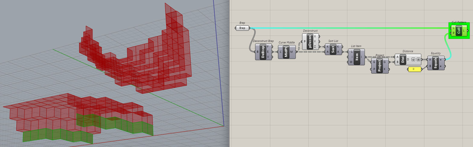

I have a bunch of surfaces and I want to dispatch them by their position, if they are matching to the xy plane or not. Any ideas??:slight_smile:

Expression on Distance output is round(x,1), which might not be necessary but good to be sure.
Amazing! it works perfectly, how would you suggest repeating this process in every Z distance?, not just in the Cplane
Start like this:
Then do whatever needs to be done.
I could have done it this way:
Expression added to both inputs of Equals: round(x,1)
