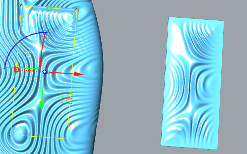

I GOT A PROBLEM I DOWNLOAD THE NIKE SHOE’S SOLE GH SCRIPT ,BUT NOW I WANT THE EXACT PATTERN TO BE FLATTEN IN A PLANE, (FOR DOOR)

THIS AREA TO BE TAKEN OUT AND PROJECTED TO A PLANE(IF HEIGHT OF RIDGES ADJUSTABLE ADDS A BENEFIT)
IS IT POSSIBLE AND PLEASE GIVE A CLEAR EXPLANATION IF POSSIBLE I WANNA LEARN
Just create a flat mesh the size of your door, or door panel, that you want the pattern on and apply the script to the flat mesh instead of the 3d mesh.
No its not possible, the pattern is generated by referencing the breb, if i am changing it , its gonna generate new rendom ones
No it will not ! Most of noise tools will gives always the same value on XYZ point. Just don’t change the parameters (here time and scale).
how to do that can you explain it more i am totally newbie
Reference your surface and post the code.
just reference a plane surface or a simple box and send the script
