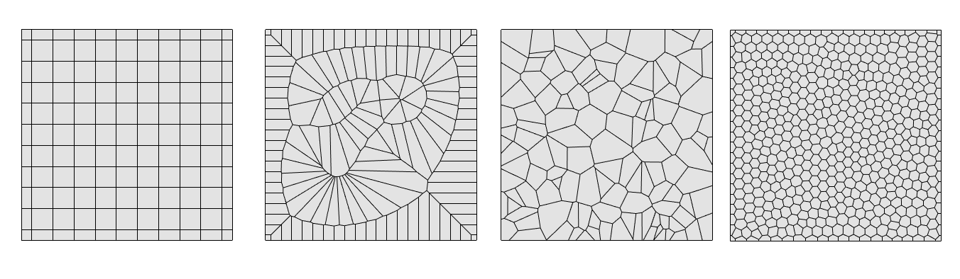

Delaunay triangulation is a process applied to a set of points, and the visual qualities of the pattern it produces depends hugely on what the distribution of those points is like (the same goes for Voronoi diagrams).
For instance, these are all Delaunay triangulations (and the corresponding Voronoi diagram for the same points):
These days I often see people talk about “a Delaunay pattern”, or “a Voronoi pattern”, when they really mean the specific vaguely ‘organic’ look of these algorithms applied to something like the 3rd or 4th type of distribution above, or somewhere between these, but it helps to be specific.
