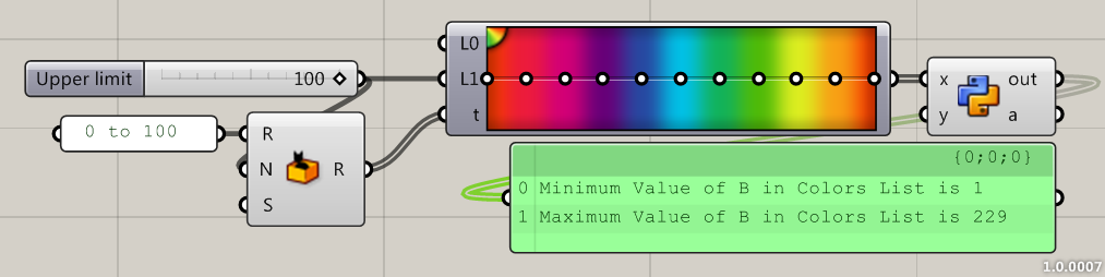

I’m currently working on a Python script that deals with a lot of colours.
I have a couple of System.Drawing.Color objects, all in ARGB mode, that I want to deconstruct, in order to get their a, r, g and b values, preferably in a list.
I’m also looking for a way to dynamically get each colour components (i.e. a, r, g, b) maximum and minimum levels.
I couldn’t find a documentation for the System.Drawing library, so I’m kinda lost here.
Any ideas?
Thank you.
Maybe something like this could get you started?
# x input set to list access and type hint color
# list containing all the B values from list of RGBA colors
B = [i.B for i in x]
print "Minimum Value of B in Colors List is", min(B)
print "Maximum Value of B in Colors List is", max(B)
