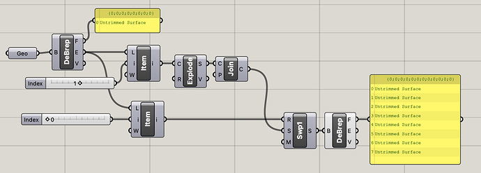

Deconstruct brep not working as expected

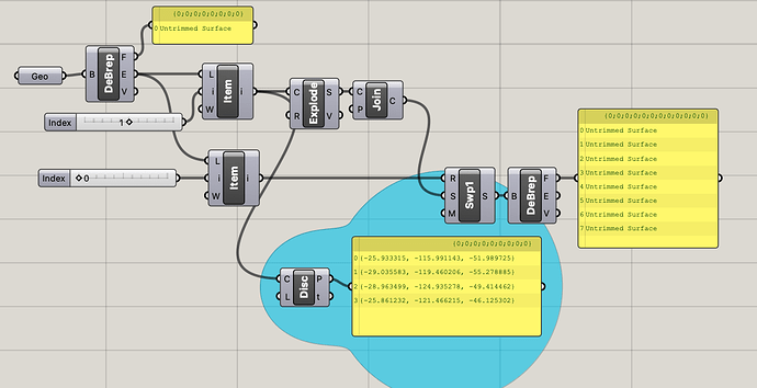

I thought the deconstruct brep component explodes polyfurfaces and gives access to the single surfaces (=faces of the brep)

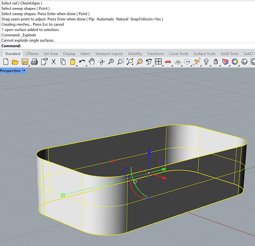

This does not work on the attached polysurface. When baking it to rhino it can be exploded into 8 untrimmed surfaces.
deconstruct_brep.gh (14.0 KB)
How did you make the input object saved in the Geo component?
sweep1 with two rounded rectangles as profiles, but i also tried on a loft.

Depending on what you sweep in Rhino, the same thing can be observed.

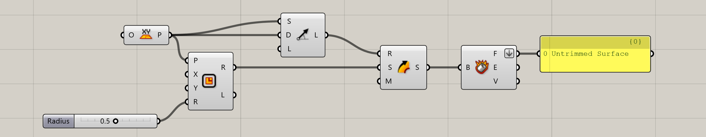

That does not work the same with a simple rounded rectangle

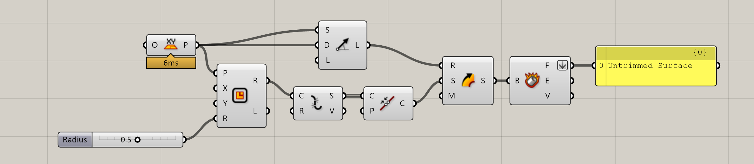

Played a bit around to find alternative ways.
And found that the difference is in Tangential Discontinuities
The rounded rectangle does not have them.
thats a well known fact. but this is really a single surface an cannot be exploded.

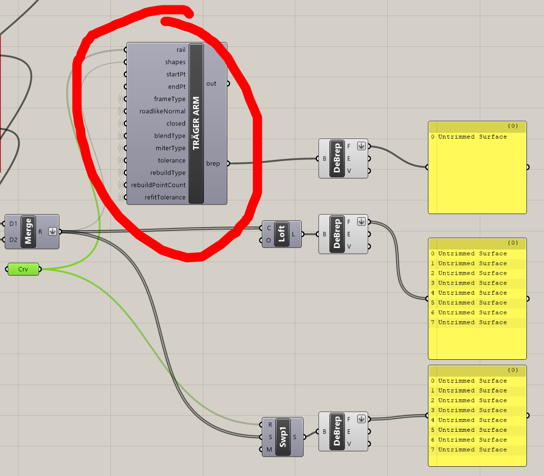

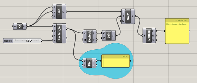

the strange thing is, that the grasshopper geometry turns out to be a polysurface, if you bake it to rhino. But cannot be exploded in grasshopper.
but when Rhino and GH behave differently (not good/bug)
I wonder which is right
and I think GH is:
I think if the curve is a polycurve like in this case lines and arcs, it should be a polysurface.
One single surface of course looks cleaner but if I wanted that, I’d create one single nurbs curve and extrude or sweep that…
In my case i prefer a polysurface, thats why i constructed it this way.
the problem seems to arise from the C# component (sweep1 with options) …
