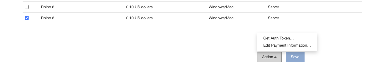

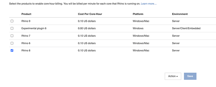

You may need to check the license portal. I have noticed occasionally I’ll have to click a check box next to the product I want to use and then “save” the user preferences. Do you see anything like that? And you said you’ve confirmed that the auth token stored in your env variable matches what you see in the license portal?
Do you see anything like that? And you said you’ve confirmed that the auth token stored in your > env variable matches what you see in the license portal?
Looks ok on license portal. Also triple checked the token, although it has also not changed since it was last working.
If you uncheck and then recheck the Rhino 8 product, do you see a little sentence show up asking if you agree to the terms? What happens if you check the Rhino 9 checkbox? I don’t exactly know why this happens (I’m not as involved in the licensing part) but I’ve occasionally had to re-agree to that statement and then hit save and then the licensing started working again. Perhaps @brian could help here.
I did try unchecking and re-checking + save
After unchecking then checking and save was there a statement that showed up? Did you retry hitting your server?

There was a (supposed non-breaking) change to Rhino Account tokens over the past week. Can you please generate a new one and see if that changes anything? It’s unfortunate that we have so little visibility into the actual issue.
@brian I did try unchecking rhino and re-checking but auth token did not change.
I also do not see any buttons to revoke/regen.
