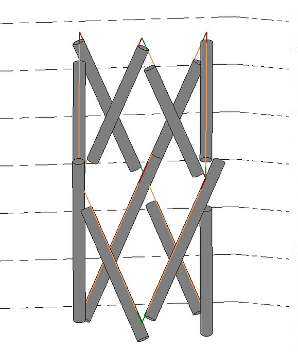

I’m experimenting RhinoInside for structural conception , analysis and detailing with Rhino/Grasshopper, Karamba and Revit.
However, when a use CurvetoBeam for Beam generation in Revit, the exchanged model considers random joins and the beams offset eachother, as in the picture below.
I will try to overide the CurvetoBeam C# script and disable the joins via Revit API (StructuralFramingUtils -> DisallowJoinAtEnd), but there is a chance of solving this in a easier way? Thanks!

Thanks for pointing this out, We have fixed this in the last release.
I would like to encourage you to do any pull requests you see fit.
Any help is welcome :slight_smile:
Hellow Kike, Actually I managed to modify the project to get it done, but basically I called DissalowJointAtEnd Method after the beam declaration in Curve.cs. I will give a look on the update!
