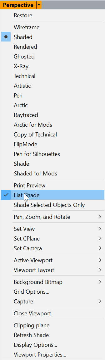

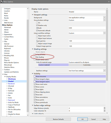

For some reason my rhino has started making all my curved surfaces looked like they are composed of line segments? How do I change this back?
Of course the render mesh IS a bunch of flat triangles, so it’s the mesh settings, or/and/or your objects are miles from the origin.
