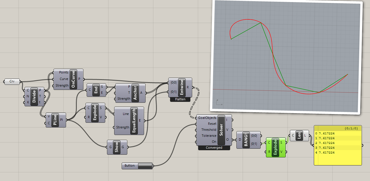

If it is the lengths of the straight lines between the points on the curve you want equal, I think the only way is to solve it iteratively:
equalseg.gh (15.1 KB)
(I was actually surprised this works - my first intuition was that it was an overconstrained problem and there wouldn’t generally be a solution. It reminds me a bit of the 4-legged table problem: https://arxiv.org/pdf/math-ph/0510065v6.pdf)

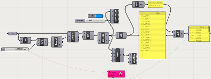

I tried doing this with Galapagos iterations but couldn’t reach a perfect match, there is always a certain missing tolerance, but with kangaroo it is perfect. Check the screen shot.

Thank your for your solution infact your way is the last way I choice to deal with my problem , thank your for your help and also your Kangaroo——awesome plug-in
Yeah, Kangaroo is the best way

I use Galapagos to build the algorithm, and the key thing is to find proper EQUATION.
Here is the result which ran 35mins, time comsuming is a problem for GA method.
anyway, check if the result match your question.
