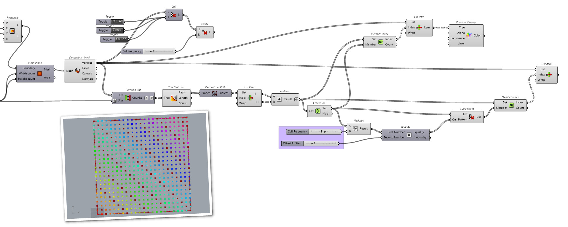

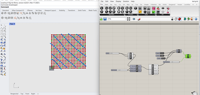

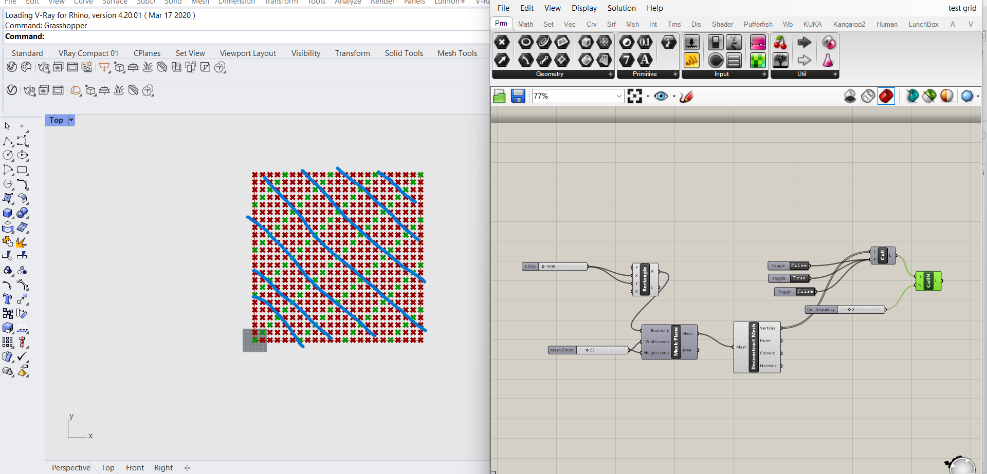

I would like to ask how to pick the points on the opposite direction (blue lines in the pic)? I have tried flip matrix but did not seem to work
Thank you
Thank you

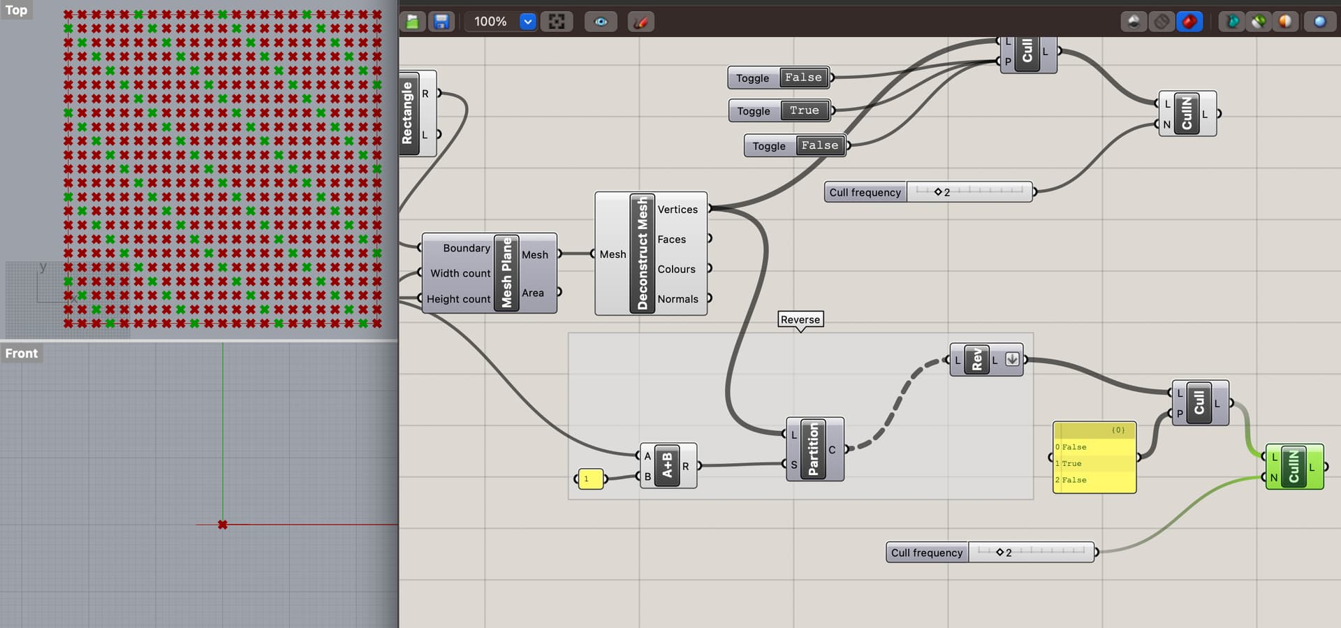

Like this?
test grid_Re.gh (14.1 KB)
Yes! Thank you very much. Didnt think of the partition and rev component
