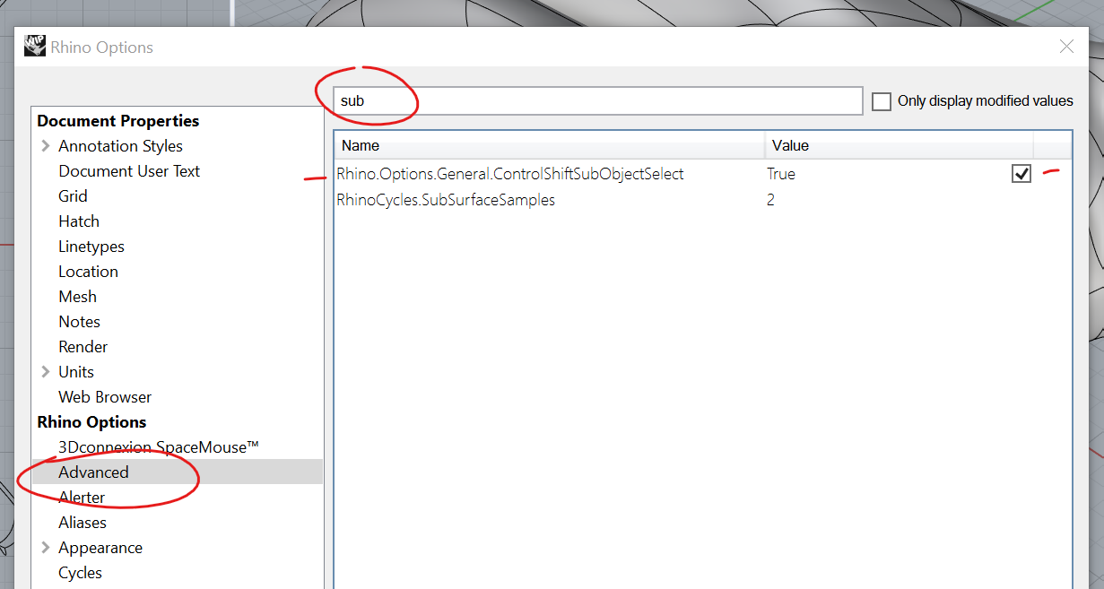

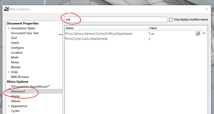

Max, do you have this advanced setting disabled?
I’m actually not able to reproduce ctrl+shift select not working with it off though so it may not have an impact. I’m hunting for some way to make this happen to help fix it. I’m on a 4k monitor here too and don’t think this could be related to that. Check your display scaling in Windows though in any case as that can cause mouse click offsets I think.
@pascal This may be related to the select filter stuff you were digging into.
It wasn’t disabled. Disabling it made frame selection of subobjects top working, re-enabling brought me back to my original problem.
