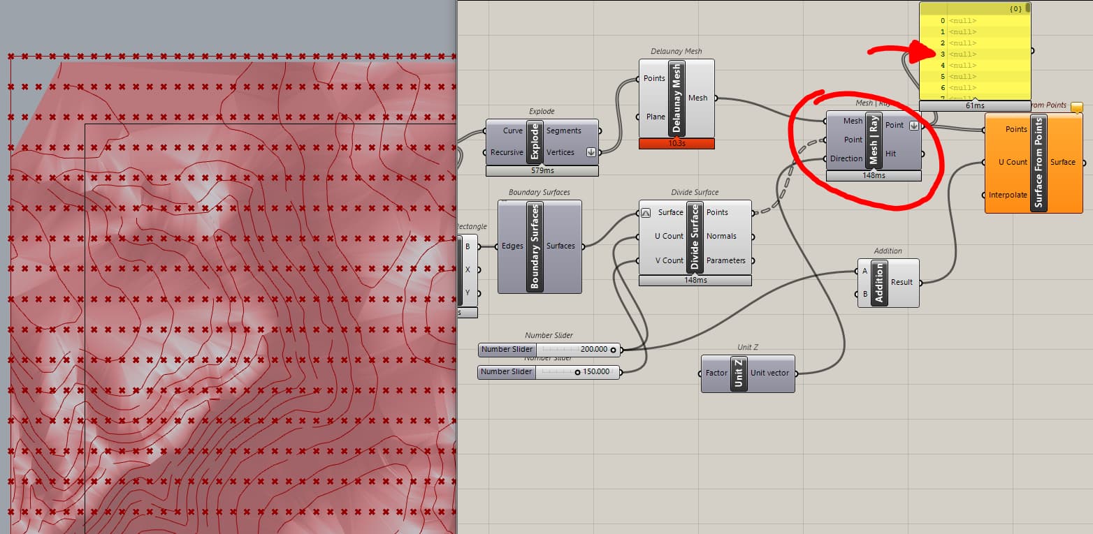

i can’t create a surface from points in grasshopper; I have only succeeded to create a mesh surface

if you set a Curve that is a bit smaller than your mesh, then it works well:
that happens because the Delaunay mesh that is created is a bit smaller than the bounding box of the mesh itself, see the trimmed corner for instance
so when mesh rays are shoot they don’t intersect anything, like in this case, and the Surface from Points gets Nulls which make it fail
It worked …Thank you so much
